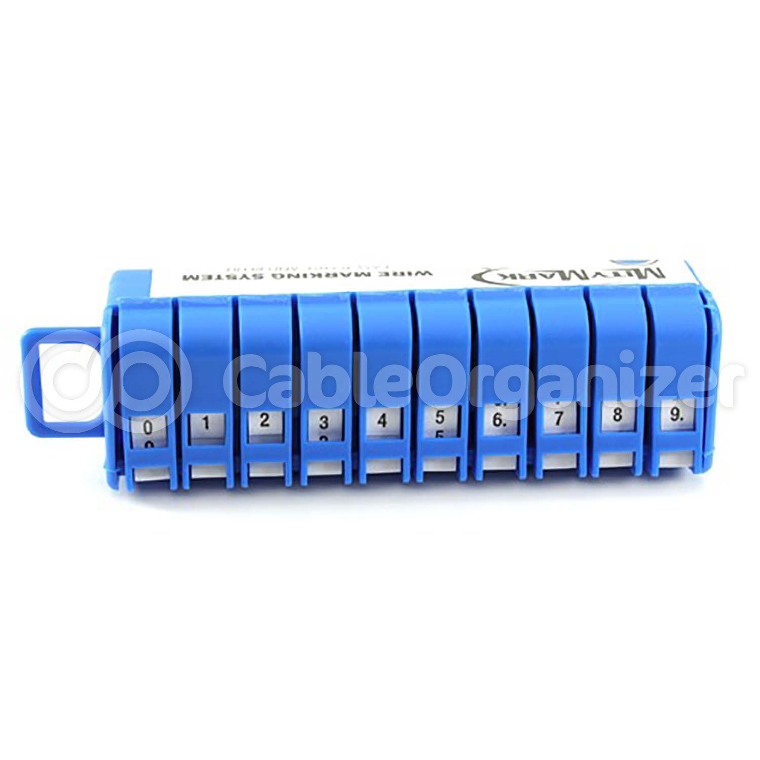

                              Back when I worked for a company that ran lots of wiring in large buildings they would label each end of the wire with a numbered tape. Then you can write down the numbers on a key and keep it. Check this out:
                              The Wire Marker Dispenser is the MOST USER FRIENDLY portable wire marker system available on the market today. Each dispenser contains 10 rolls of marker tape, numbered 0 - 9. Each roll contains 76 individual markers with a pre-determined length of 1-1/4" and a width of 1/4". A total of 760 markers per dispenser in a c
