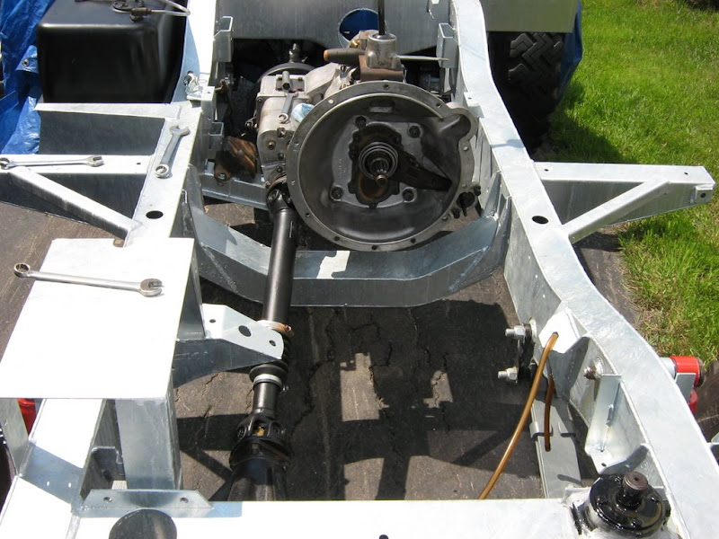

                    Finished the transmission rebuilt, install it in the chassis than the engine followed. A big long day of work.

                      Nice use of scaffolding!
