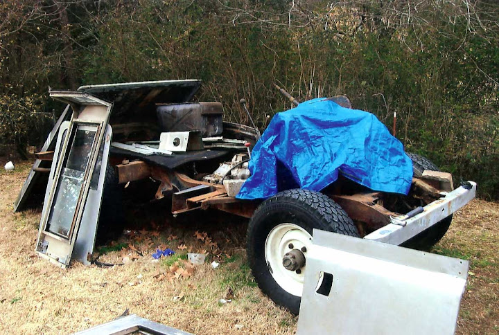

you need at least 2 running series to do a frame over properly. take the running series with the worse frame and start disassembling. take the other and drive away, don't look back'64 Series IIA 88 Canvas Tilt
