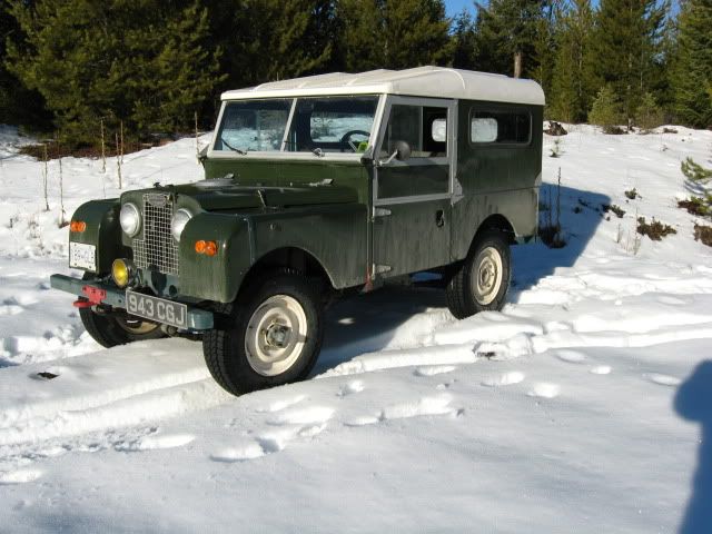

    I fabricated a bumper for the ser1 out of 3" square tubing that was 1/8" thick. I went with this as it would be light enough and was the about the same thickness as the frame. Cut out the ends to the same radius as the original, heated, bent tabs, and welded it up. Welded on mounting tabs from 1/4" stock drilled and welded in. Ground off the hand crank fitting to refit onto the welded tube to pass it through.
    All done in true old school fashion using oxy-acetylene and arc welding. Can't tell it from original unless you look closely.
