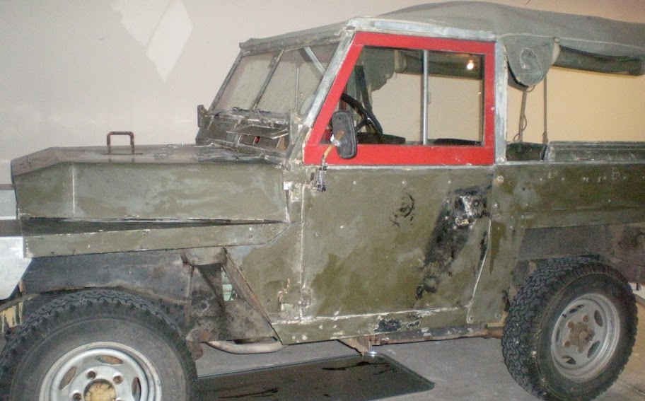

    Just wanted to say hello as I have just purchased a Series III Lightweight. The plan is to make some minor upgrades to the Rover and keep it running until I can get to a proper restoration.
    As for the minor upgrades, I'm considering the following:
    1). Upgrade to Defender style side mirrors
    2). Inertia seat belts
    3). Identify and mitigate rust issues
    4). Odds and Ends to keep it running...
    Picture below... BTW, for those of you who are interested this was Les's former Lightweight...

                  Here's an updated picture of the Lightweight. I have about 95% of the old paint removed. The factory finish is in pretty good condition. I was going to work on the Rover today, but SWMBO had other plans. I did manage to get in an hour's drive around town.
                  So far, I've noticed there's a lot of work to do... What else is new? Once the military paint is gone, I'll be polishing and waxing the factory finish. Then I'll add the new Defender Mirrors, the new rear view mirror, the new tailgate license plate frame. I then will be working on the near endless of repairs...
