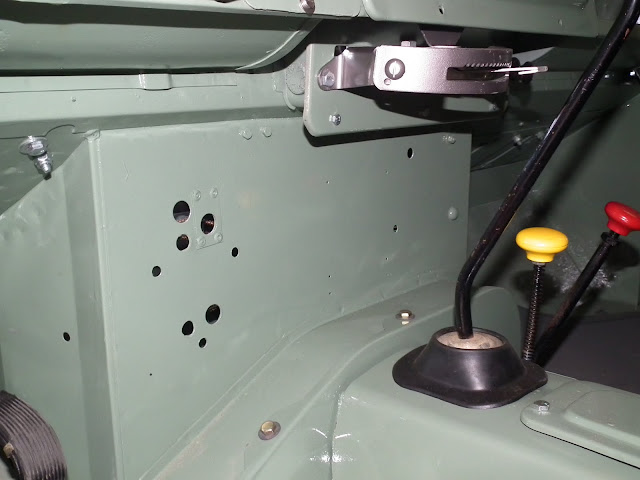

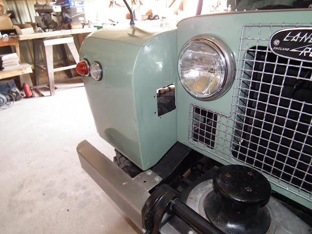

    I'm wondering if this hole is from the PO, or if it's from a heater for fresh air. There was no heater when I got the truck. Anyone know which heater would best suite a SERII in Canada. I assume a Kodiac, but don't know which one or where to get one.

    Im pretty sure that's not a stock hole. I hear the kodiak is best and that Pangolin4x4.com may have some. I also hear the mt mansfield from our hosts is good.

      Have no idea about hole #1 never seen one like it. Hole #2 is for the "shin burner" SII, SIIA heater, stay away from that one they don't call it shin burner for no reason, as stated a above give Ike at Pangolin 4X4 a shout.

          I holes in the second picture are for sure for a Smith heater (Shin burner).
          The first picture is an air intake for a odd type of heater that was used on some rovers imported into Canada. I'm not sure of the make but I think it it was another type of smith heater.

            I believe some Kodiaks did get its fresh air from the front of the Rover. However that one definitely looks homemade and could have been for just about anything. I am sure more knowledgeable people will chime in - like Ike.

              I agree that the 2nd photo are holes for the shin burner - or for a shin burner and for the next one of dubious ancestry that was put in after the shin burner broke.
              My guess for the first photo is that the original owner was lifting the hood when holding a pistol, the pistol went off blowing a hole in the fender and the previous owner only knew how to fix a big hole.
              I wouldn't be surprised if the hole in the fender is for some sort of access for something mounted on the front. Bracket to hold something? Access hole so that they could get at some part of a winch? You know, kind of like putting a hole in the side of your garage so you can pull a half shaft out.

                    One of the early versions of the Kodiak heater does indeed draw its fresh air from that location. But I believe the intake hole is shaped differently. The version of Kodiak with that location intake also has some large hoops suspended from the underside of the wing top to support the intake hose.

                      I always seen the Kodiaks that draw air from the front routed to the small spot below the headlight... behind the breakfast. NEVER cut into the wing like that...

                        I believe the first Kodiak version has the fresh air intake on the radiator bulkhead as you mentioned. The second version had the intake opening on the inner wing panel just forward of the radiator bulkhead where the hole in question is located. Later all versions after that had the intake hole near the back of the outer wing panel. Both early routing versions were in production for a short time.
