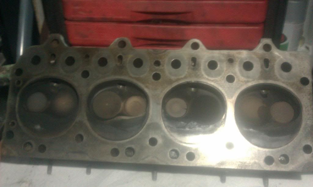

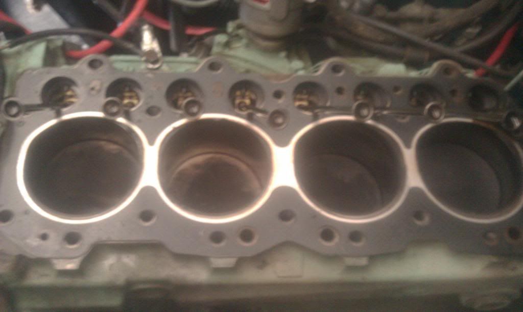

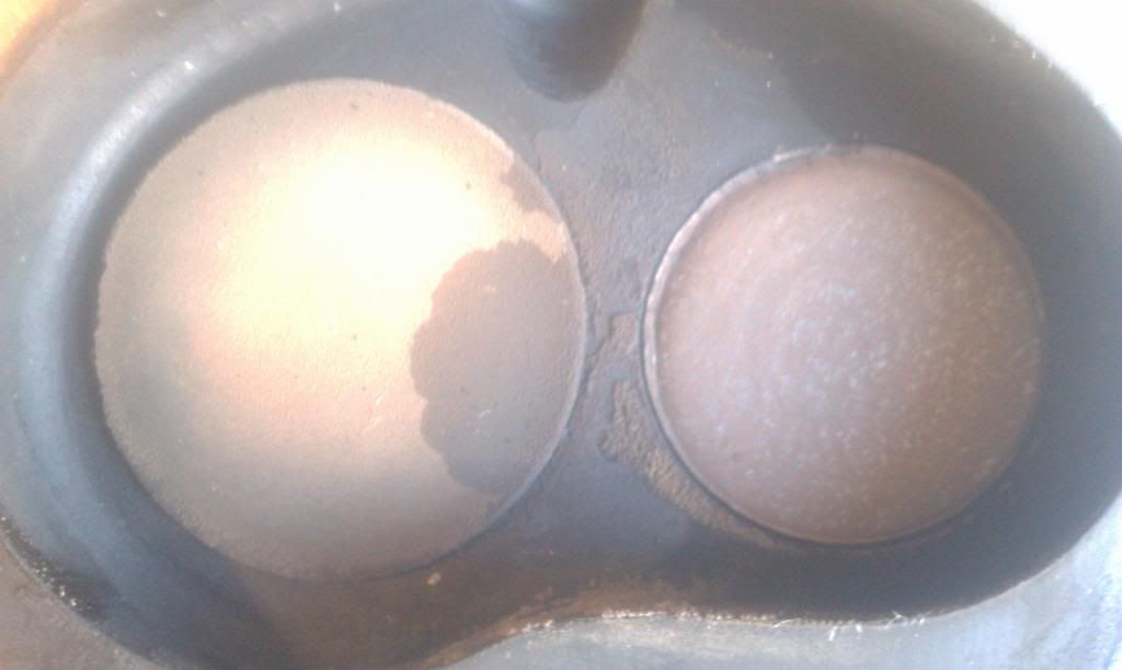

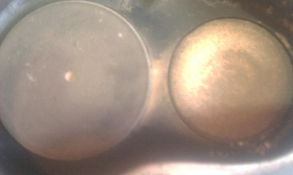

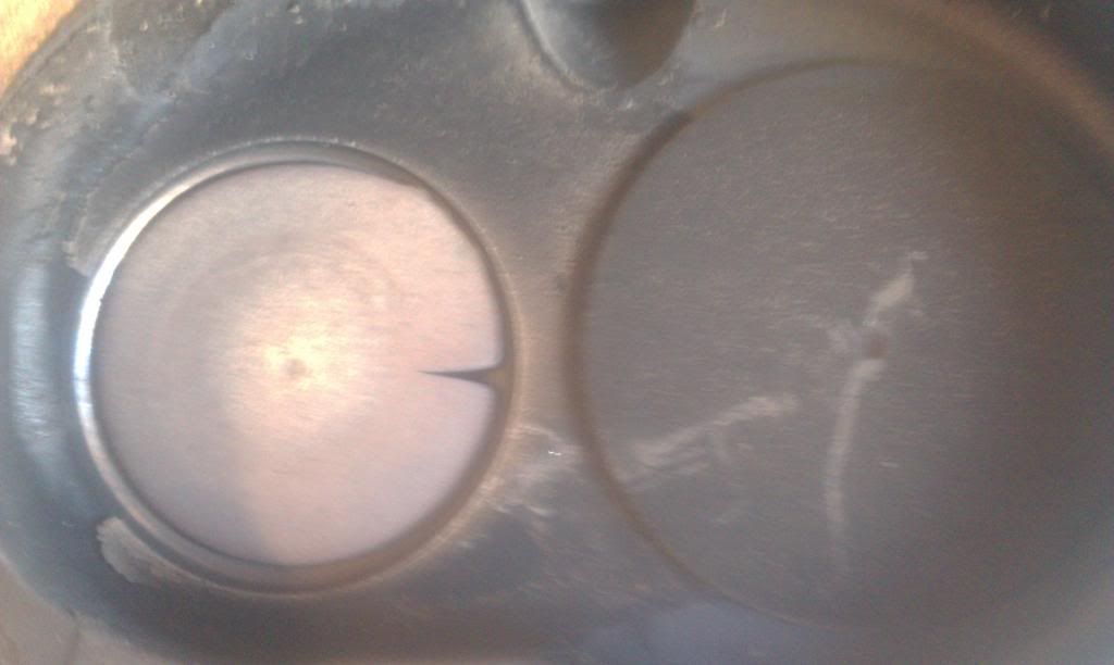

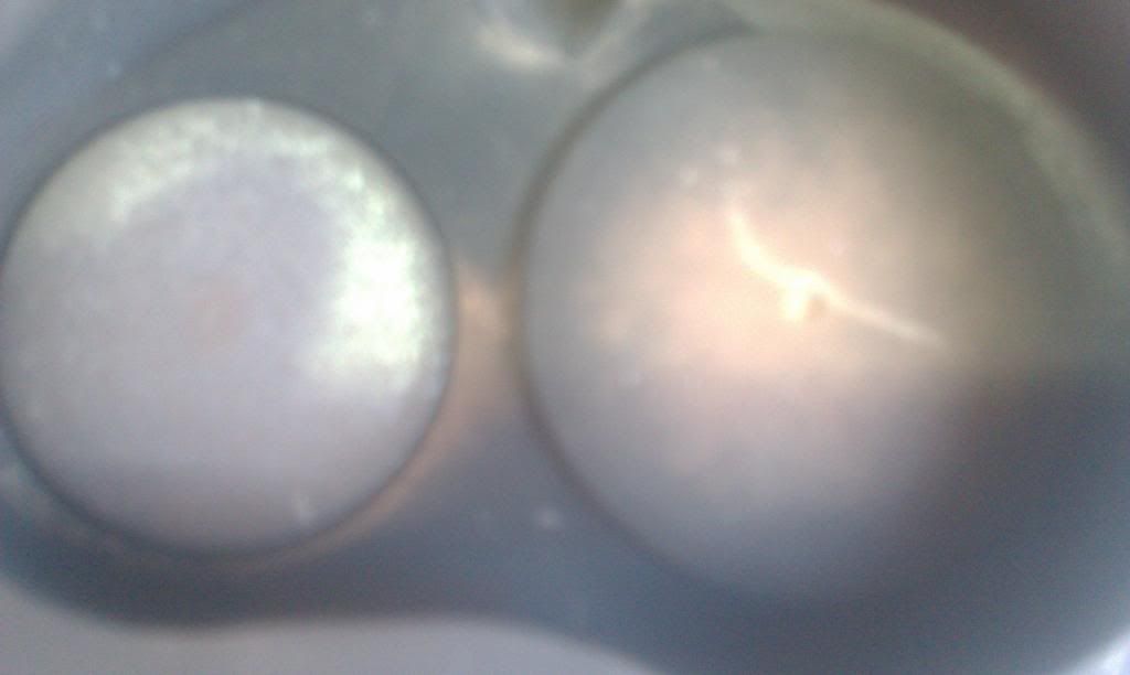

            So i pulled the head and sure enough exhaust valve #2 has been burnt and #1 & 2 look like they have been warn down some. I guess that explains the 120 compression vs 130 on #4.
            I did just do a 5000 mile trip and going through the mountains in Colorado was a bear on what im guessing was 3 cylinders.
            hope to have it to the machine shop monday. any idea of what it will cost to get the work done?

              local machine shop to me used to charge $180 for a 3 angle valve job with new valve seals on an 8v head. You might just buy all new valves if they are not too pricey and have new hardened seats put in while you are in there.
