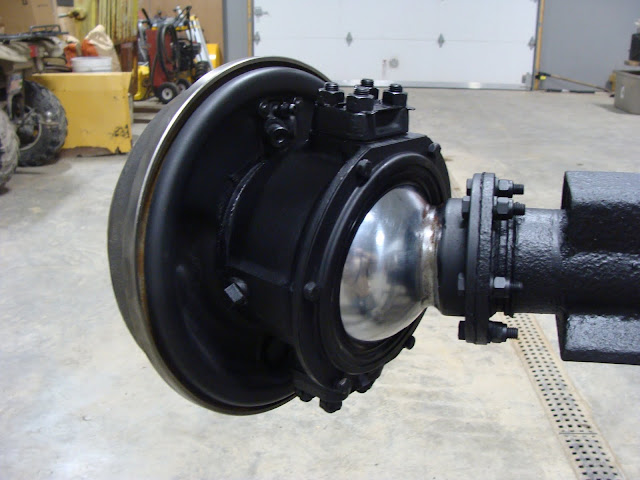

                        I thought this was a ingenious way to tape of the swivel balls.
                        Just for the record ,all painting was done in a EPA approved paint booth facility.
