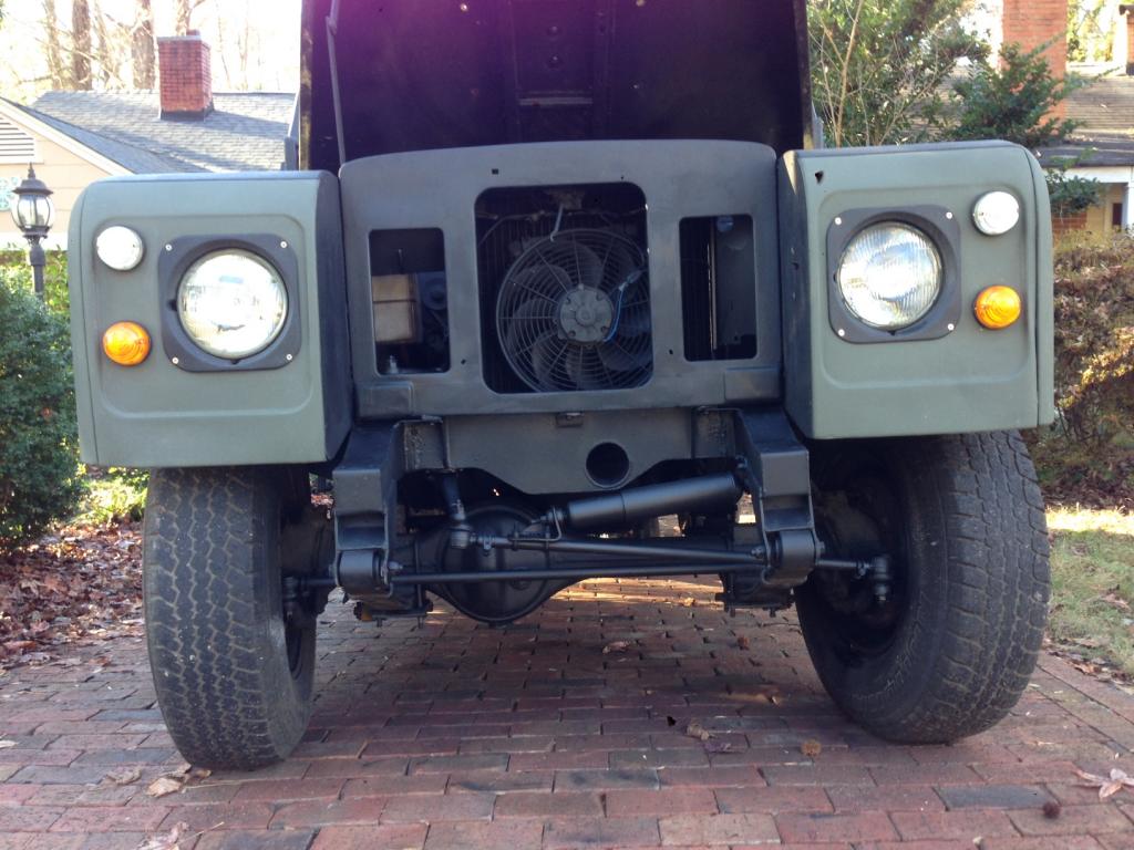

Found one, spent hours with the wire wheel to clean it up, had it galvanized, painted it, had the old one cut out and the new one welded in and gusseted, and after around a $1,200 investment, my rover now steers no better or worse than it did before, though it is nice to no longer be able to reach up inside the cross member from the bottom and grab handfuls of rusty metal.
The moral of the story, when looking at rover online that is listed as having "some rust", save your time and look elsewhere. I've already spent more on the frame of this truck than some really cool rigs are listed for. Before my next series purchase I'll be looking for the following magic words "galvanized frame".'75 SIII 109 Diesel - I'm in deep.Comment
