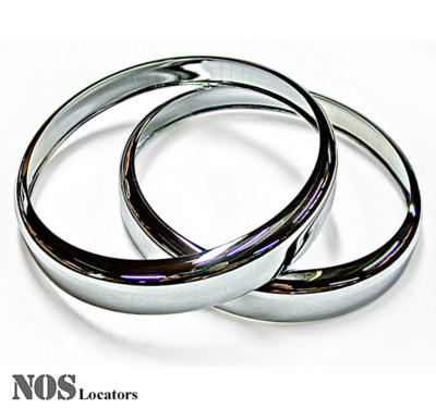

        These should be standard Lucas parts, right?
        MGC & MGC-GT : 1968-69. Cobra Kit cars. Fitted with MGB type headlamp assemblies. MGB & MGB-GT : 1962-79 to car #505066. (WillNOT fit 1980 models.). Jaguar XKE Series 1.5, 2, 3 : 1967-74. This rim fits the original 8" headlamp assembly.
        The seller also has early rims.

          Apis--Thanks, but those are 8'' rims. As I found out last night, I need 7" rims.

            The lamp is 7", but the ring is 8". Unless the Bugeye uses a different lamp than the standard 7", those should work. There are two types: one that is retained with a set screw and one that snaps on.
            I don't have specific experience with a LR Bugeye, but I do with an AH Bugeye, as well as, several MGs and TRs; most British vehicles of that era use the standard 7" lamp and the same size trim rings. The LR should be the same.

              The Land Rover rims are 8" outside diameter for 7" headlights. The Rover part number is 142001. Rovahfarm has them listed for $60 each. They have a small bracket at the top and they use a screw to retain them at the bottm. The retaining rings (that use 3 screws to hold the headlight in place) are about 7" outside diameter. The Rover p/n is PRC7992. Rovahfarm has them listed for $24 each.

                Thanks everyone. I've purchased the ones from ebay, and will let you know how it turns out. I just wanted to be sure that 8" rims will work. If they don't well, I can return them, or purchase new head lamps. Next project is the engine, and then the brakes...Happy Rovering!
