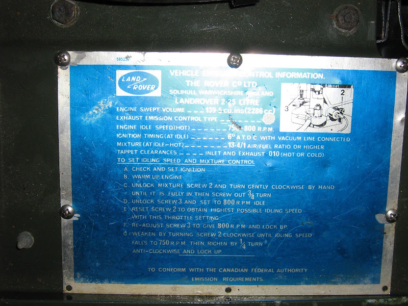

To do it properly, you'd need a timing light, for example. There are other ways, but really you can tune it by ear.
Loosen the 7/16 nut on the clamp securing the distributor just enough so the distributor can be rotated with a little effort.
Start the engine.
Twist the distributor until you get an even exhaust note.
Drive the vehicle (distributor still loose). The engine will run with a wide range of timing, but you can make subtle adjustments (with the engine running) until you get the balance between power and no detonation.
With a worn timing chain and/or distributor, it's impossible to set it at precisely X degrees with a timing light and you can get satisfactory results without it. Some people call it "the beer method". I'd call it "the sweet tea method", regardless, basically you place a full beverage glass on the fender and adjust the distributor until the ripples in the beverage are smoothest.
That said, also check the carb (mixture). What did the plugs look like? A lean condition can produce the same symptoms - hot, needs choke, etc.
PS my SIII also needs some choke when cold for probably more than 10 minutes and it also has an occasional "glump" backfire at idle. I consider that normal for my truck. Mine doesn't run hot though.© 1974 Apis Mellifera. Few rights preserved.Comment
