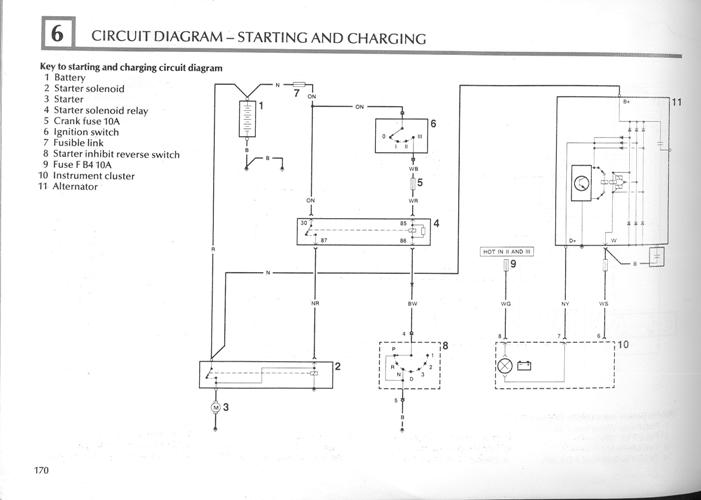

New to forum and RRC so just learning my way. My 1994 LWB was starting and running fine. The heater completely stopped working so I started trouble shooting with relays and fuses first. After checking fuses under passenger seat to find if blower motor fuse was bad the truck would no longer start. When under seat I also removed all relays to check if blown. Dash lights come on when trying to start and there is a clicking coming dash and from under the passenger seat. Electric is all working. Seems like electric not getting to starter. Any advice.
