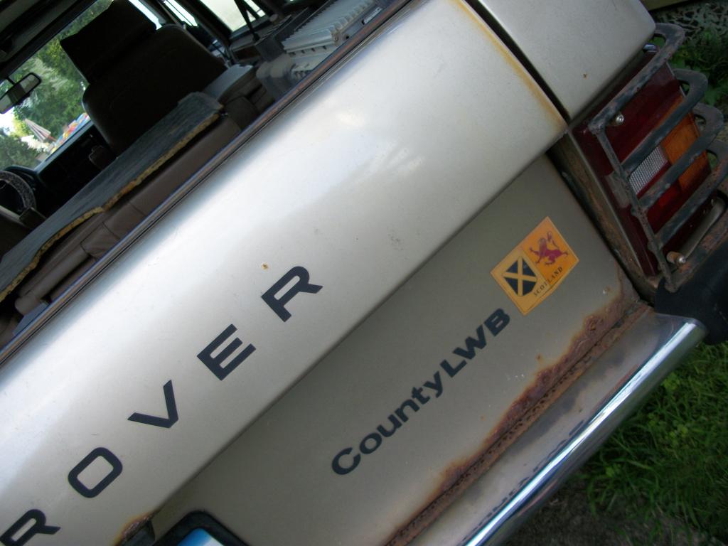

    I hope this pic shows up. It's the only pic I can find of the rear of my wife's old Rangie. But it does show the placement of the "County" sticker.

      I have a '93 LWB with the old stickers and mine measures for the county emblem 3 3/4" from the right side of the B at the lower fat half and 4 3/8 up from the bottom of the tail gate to the B. The RANGE ROVER emblem measures 11 1/8" from the right and 2 1/8 from the bottom of the under curl. Just use these measurements and draw a line with a pencil (it wipes off) place masking tape along those lines and line up sticker group done.

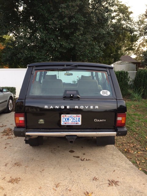

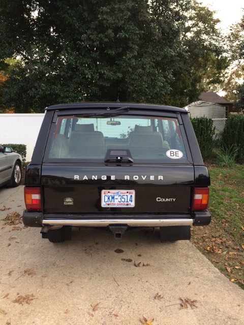

                Put the letters/decals on yesterday! Look okay?

                  This is odd but the words RANGE ROVER on the front of mine are 16" to the R on the passenger side and 15" to the R on the driver side.
                  All letters are 1 1/8" from bottom of the hood. Spacing of the letters is also odd range from 1 1/14 to 1/3/8 but the space between the E and the R is 3 1/2" I'd say find center and call it good.
