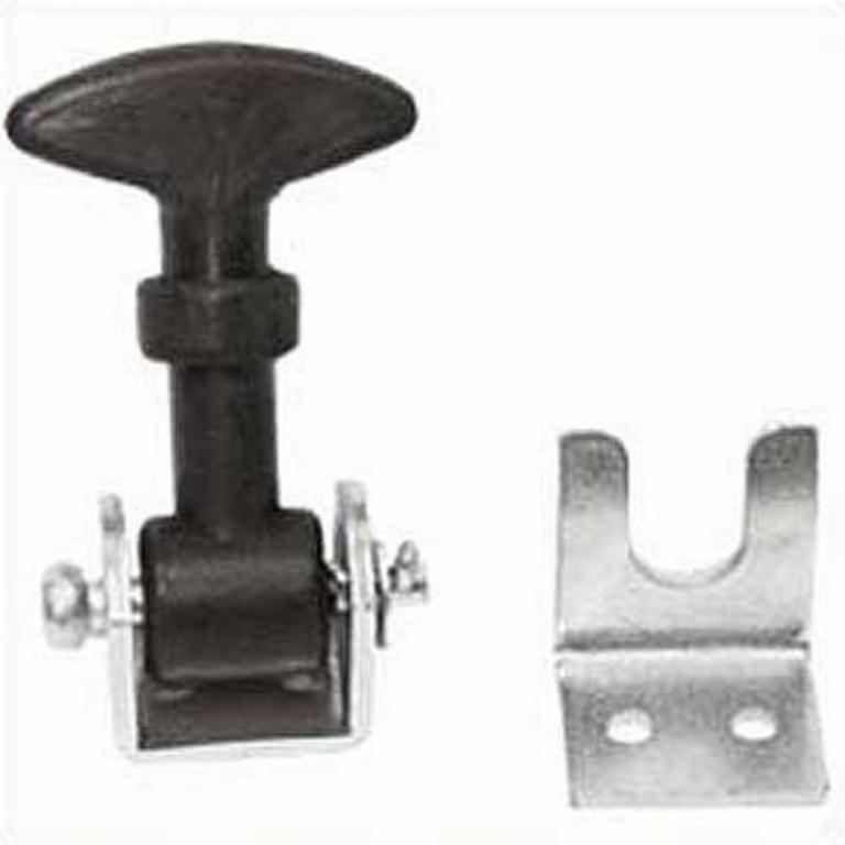

            #6
            I had these and they were awesome. Never another worry.
