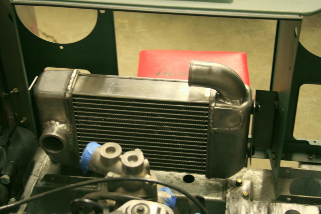

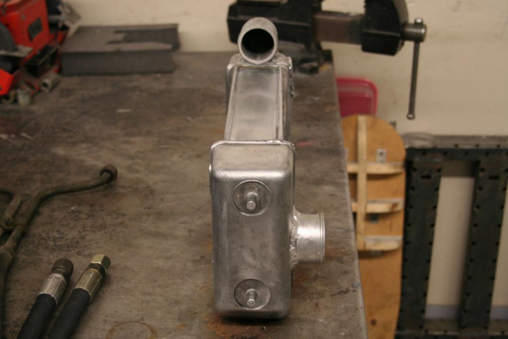

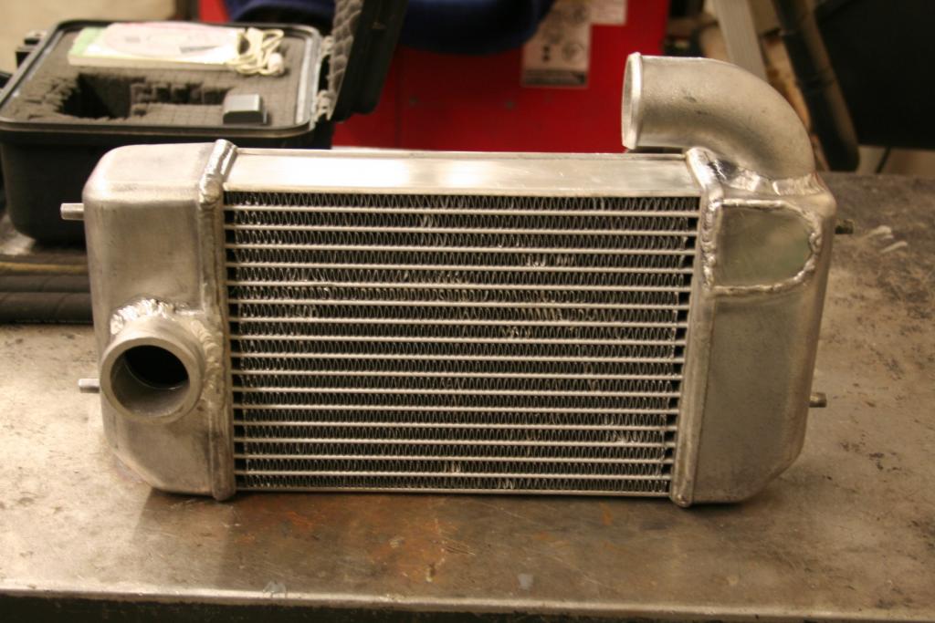

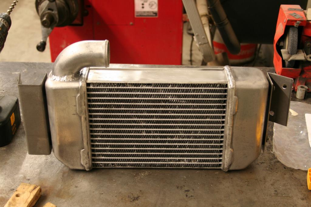

Your stock intercooler (provided one came with your engine) can be reconfigured to work, I just did mine (photos hopefully attaced). The inlet/outlet just need to be cut off, one capped and moved, the other just re-shaped, and re-welded into place. The catch here is you or someone you know need to be relatively proficient with a tig welder. Bell intercoolers can make one up for you, they are familiar with TDi conversions and space restriction in Series trucks, about $600.
