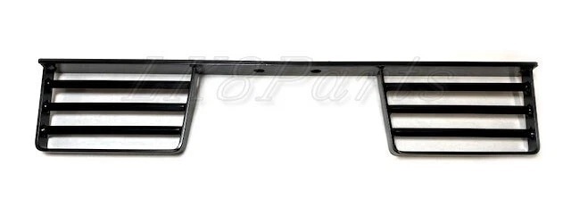

    Does anyone have an idea where I could get a rear step that would attach to a series 3 88 military cross member. The folding steps I have seen apparently are only for the civilian rear Cross members.

    There are aftermarket fixed steps available from several sources that bolts to where the tow hitch mounts. I have the left half step on the wife's civilian chassis 109. IIRC the hitch bolt holes military chassis have a different spacing than the military chassis, but you could likely modify the step to fit, I often see them available on the big auction site.
    I can measure the bolt spacing on my ex MOD chassis and the wife's truck, if needed.
    Bob
