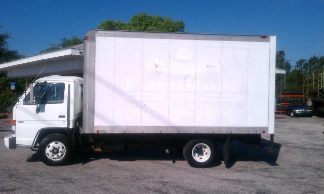

                    Google "Isuzu NPR" look for late 80s early to mid 1990s. They look like this: Click image for larger version
