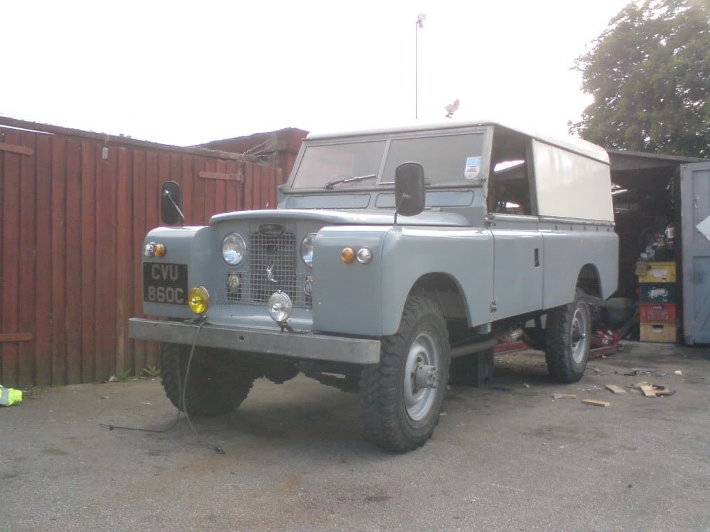

    this one is a 1965 109 2.25 petrol utility, bought it non running and knowing there was going to be welding and a full stripdown ahead along with a couple of modifications (bought with spare bulkhead)
    so i dragged it home and parked it in my front garden for about a year whilst i collected stuff/parts

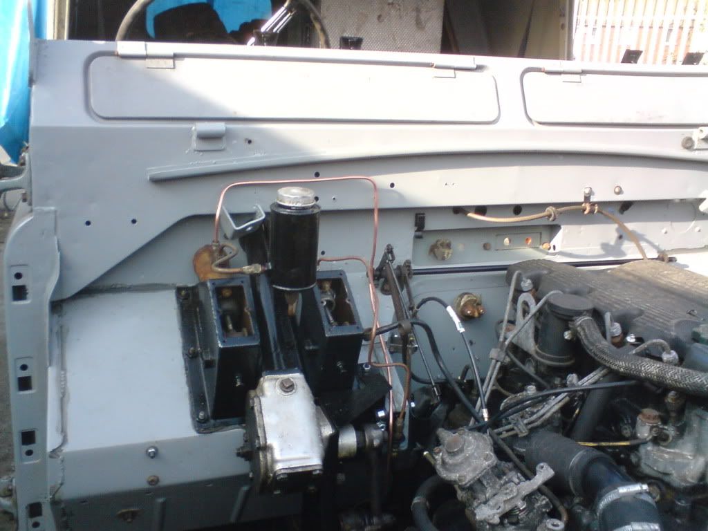

    eventually i'd got enough bits to start and it was time to repair the bulkhead (correct start point in my opinion)

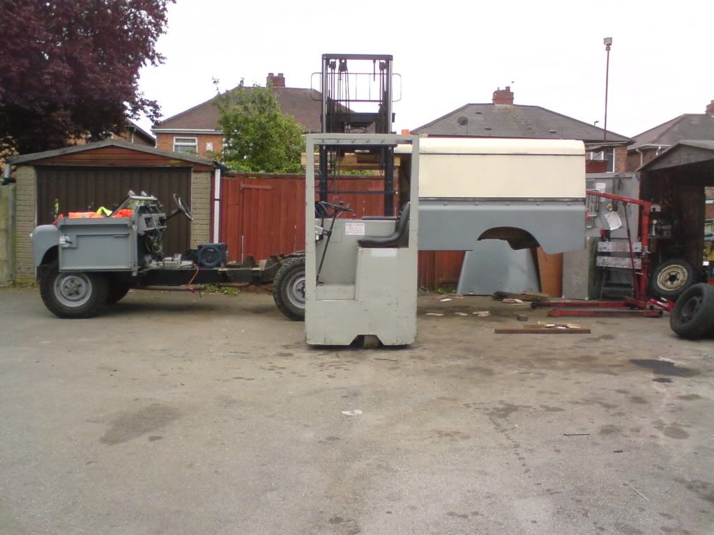

    that repaired and painted and it was then time to get Big Ears out the back into my workspace/yard and get stuck in
    rebuild both dumbirons and the crossmember
    replace two drivers side outriggers (that means the right hand side here )
    pull the engine gearbox and bulkhead out and clean up the chassis back to the tub and replace the blown front springs

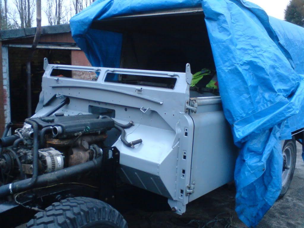

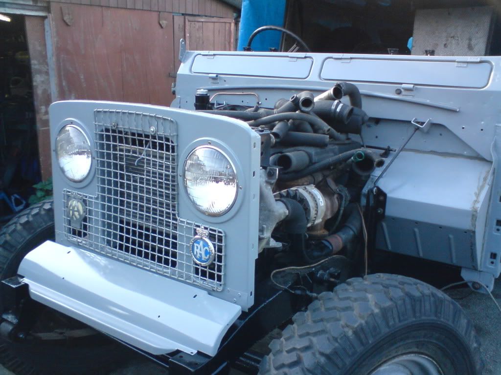

    well we've finished the front half of the chassis and it's time to install the engine and 'box (slight upgrade)
    yes that's a 200tdi with 300tdi turbo

    refit the bulkhead and doors, spend ages getting them lined up correctly and now the doors close with a nice click
    clean and paint all the bits i removed from the bulkhead and then refit

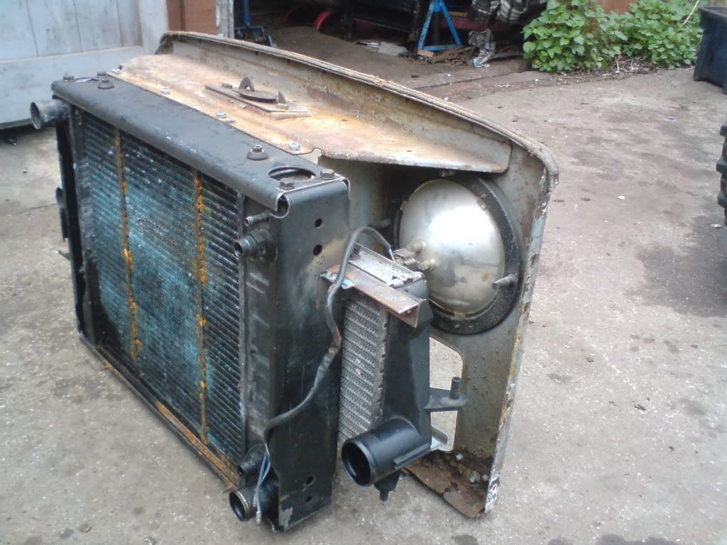

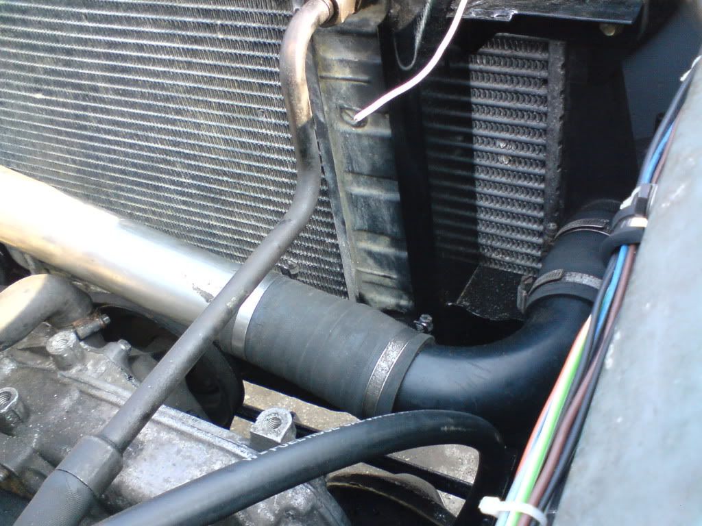

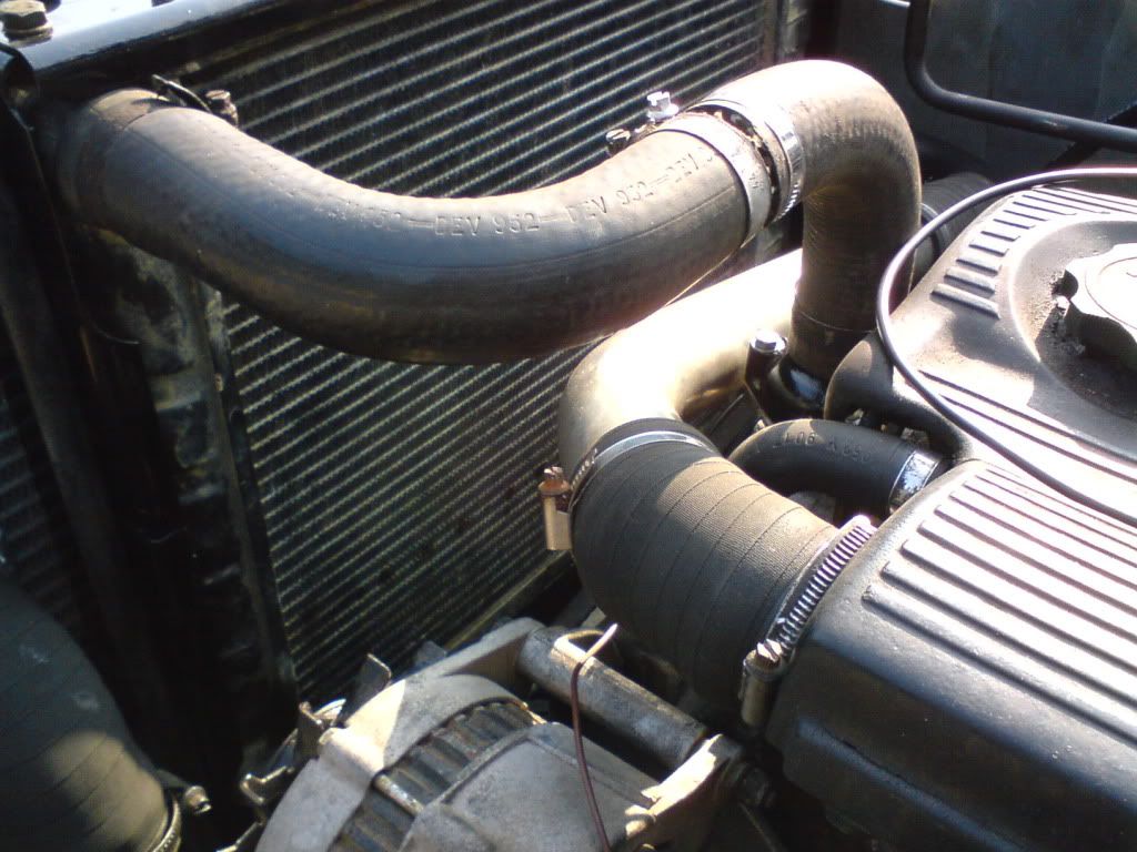

    next was to experiment on fitting the radiator and intercooler (200tdi rad' , TD5 intercooler)
    cut down and modified 200 rad' surround, rad' panel and mounted intercooler
    all piping, panels and surround painted and mounted
    starting to look like a landrover

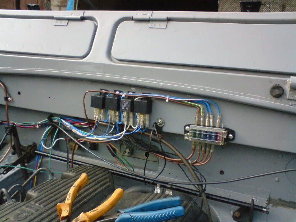

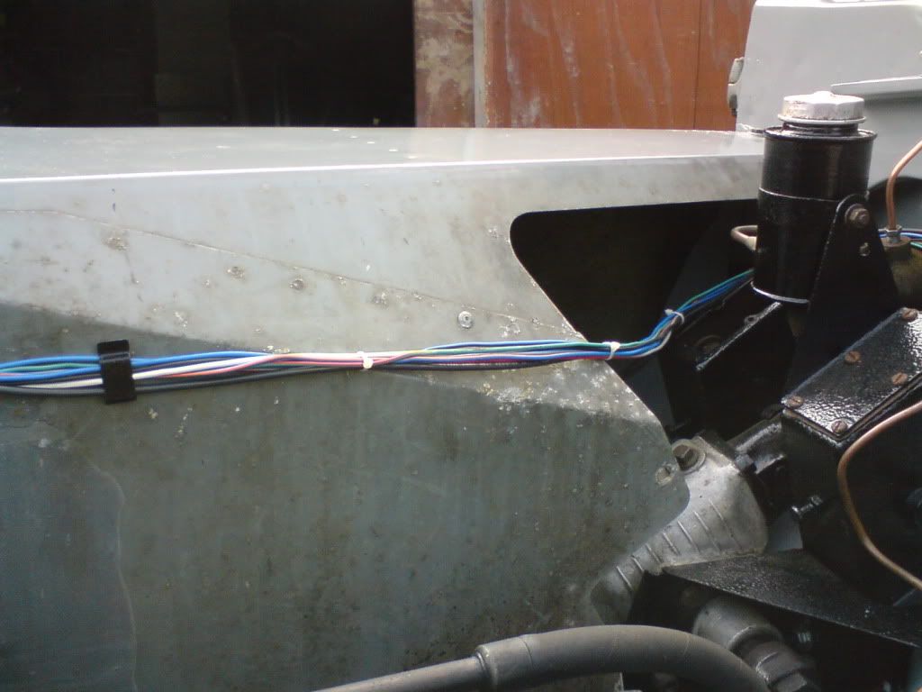

    my next modification was to build my own wiring harness with a couple extra fuses and relays for lighting and fan

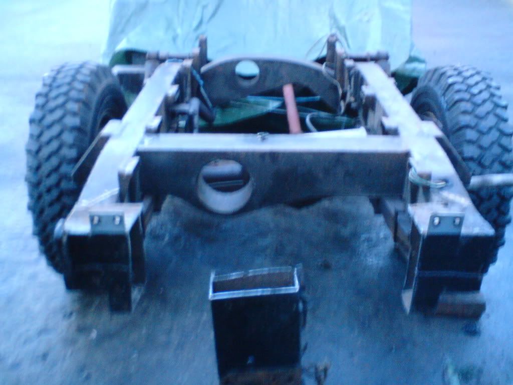

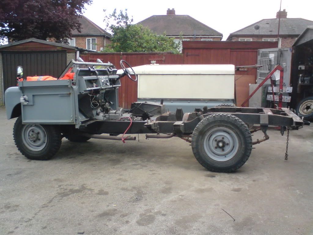

      but now we have to start the back end
      a little rot/outrigger missing
      jig for crossmember repairs/replacement
      more weetabix

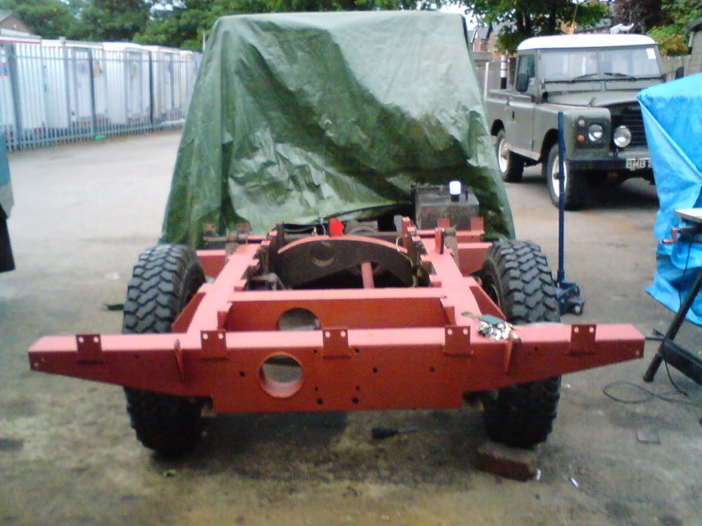

      and miraculously all back together (i forgot to take a few photos)
      i also forgot to take any photos of the blacking before replacing the tub

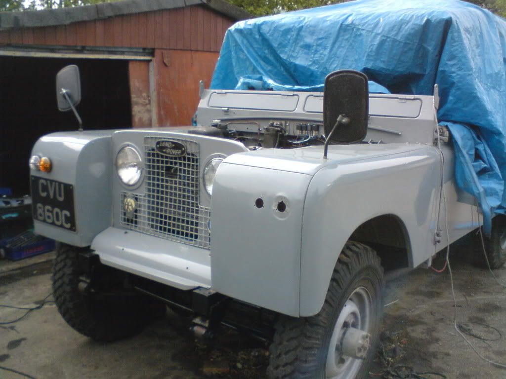

      more bits on
      and the day i took him for his Mot (roadworthy test)

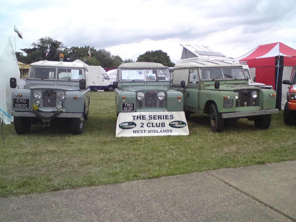

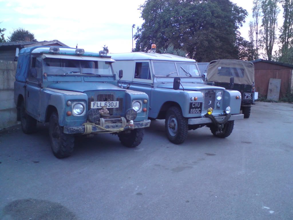

        his first show with the Series2 Club

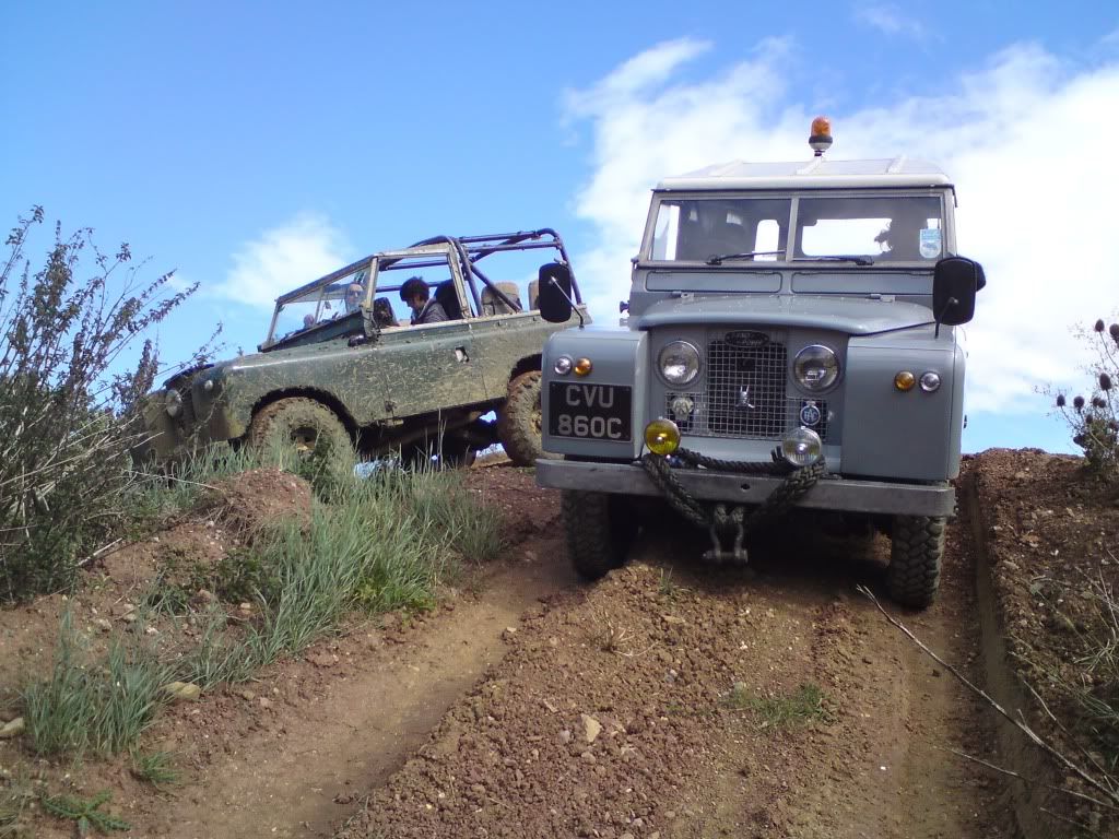

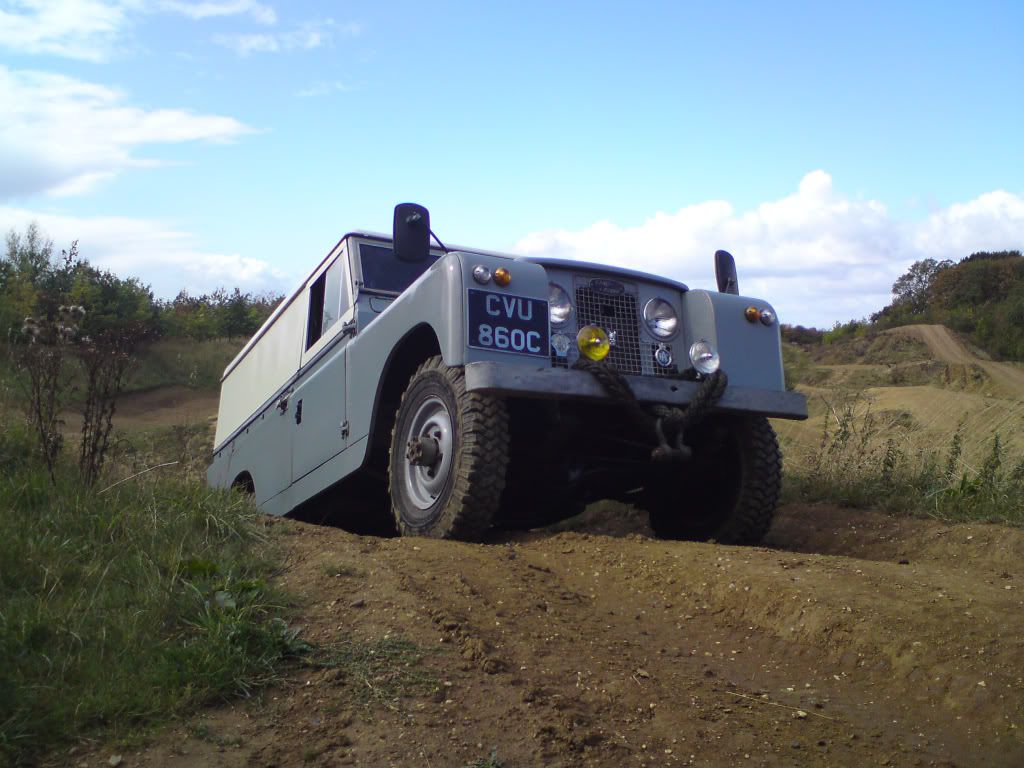

        and my first weekend out playing with him, being careful on the offroad course
        paired up with Zebedee
