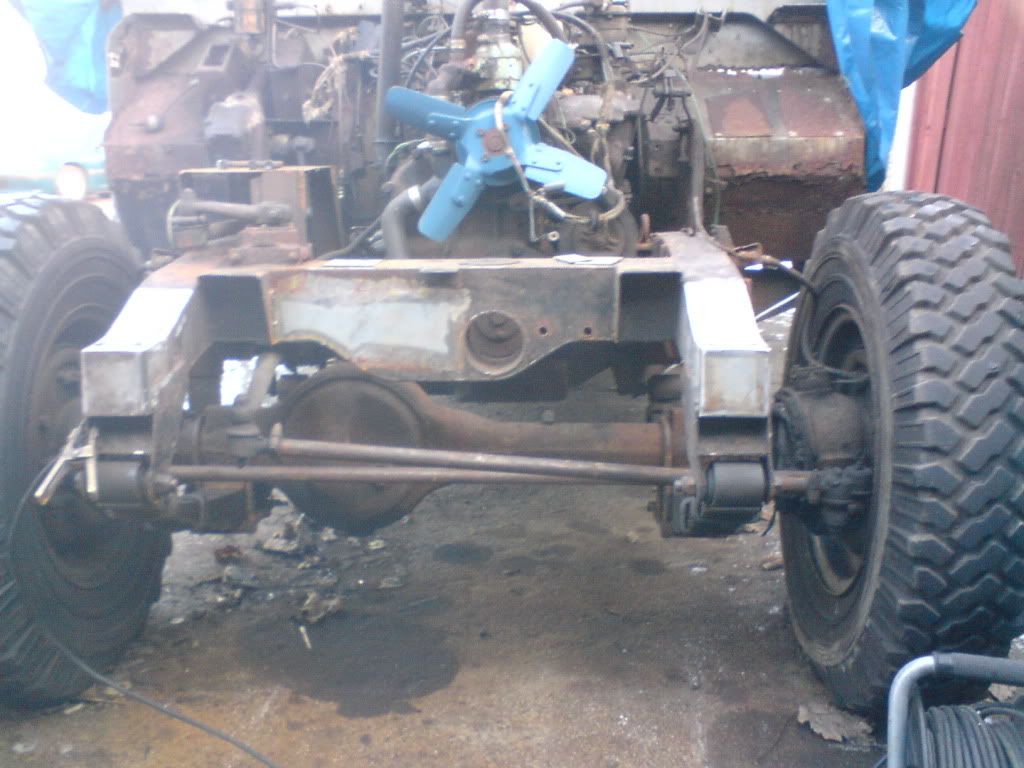

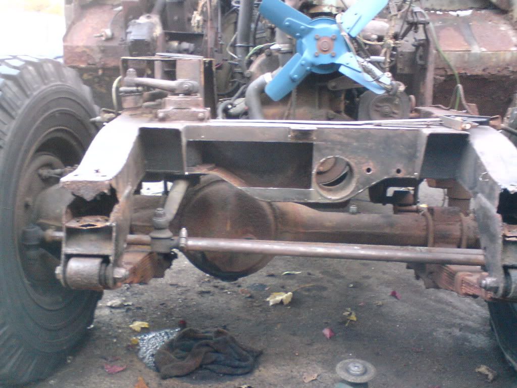

    rebuild both dumbirons and the crossmember
    replace two drivers side outriggers (that means the right hand side here )

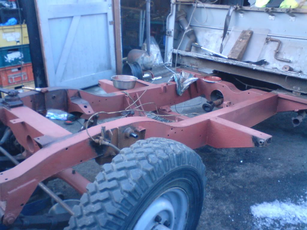

    pull the engine gearbox and bulkhead out and clean up the chassis back to the tub and replace the blown front springs

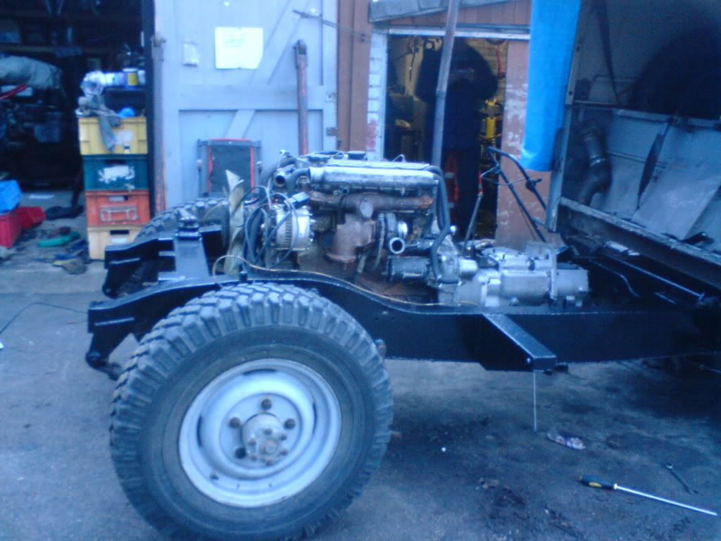

    well we've finished the front half of the chassis and it's time to install the engine and 'box (slight upgrade)
    yes that's a 200tdi with 300tdi turbo
