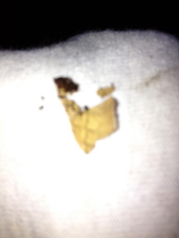

Because it is intermittent I am hesitant to blame the carb, although I have a rebuild kit and if it comes to it I'll rebuild it. It has a generic Purolator filter right before the carb and I recently replaced it but the problems still occurred after. It's the clear kind and usually it sits about half full. The old one looked well used but no obvious signs of dirt in it.

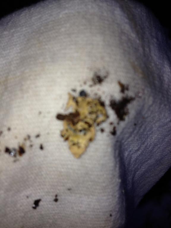

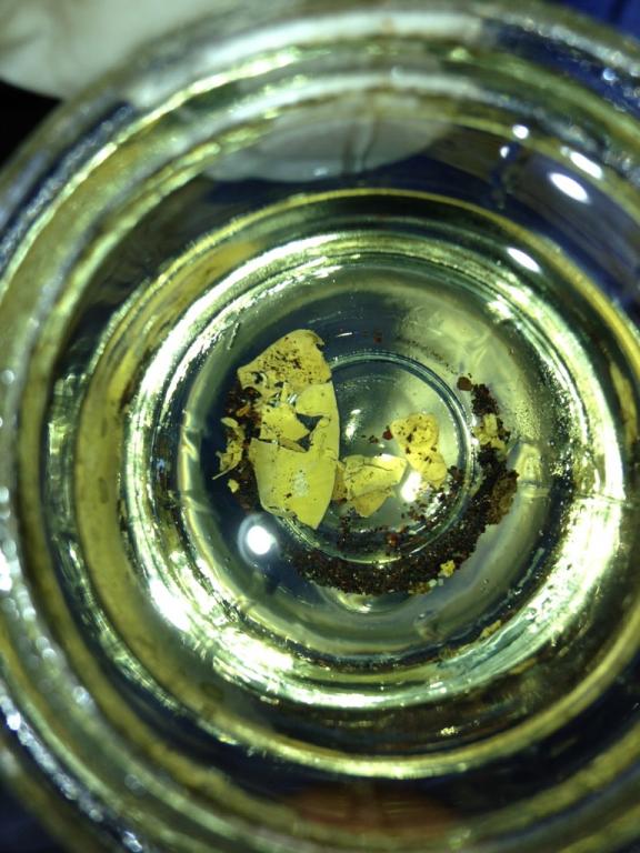

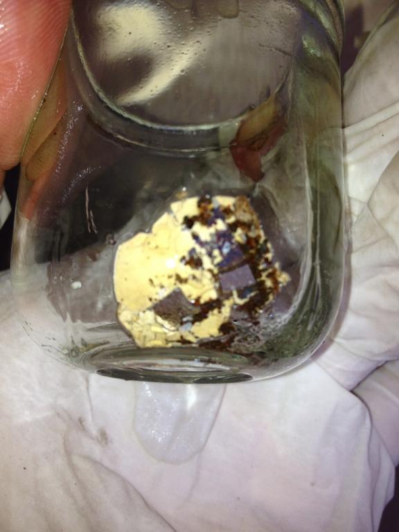

The truck is running fine at the moment, but while doing other maintenance I did notice a bunch of crap in the fuel pump sediment bowl which I have since removed.
If you have any idea what the yellow looking material is, please let me know.

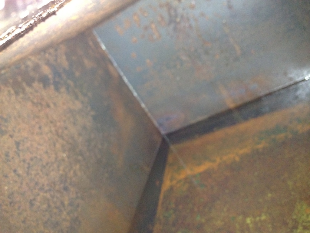

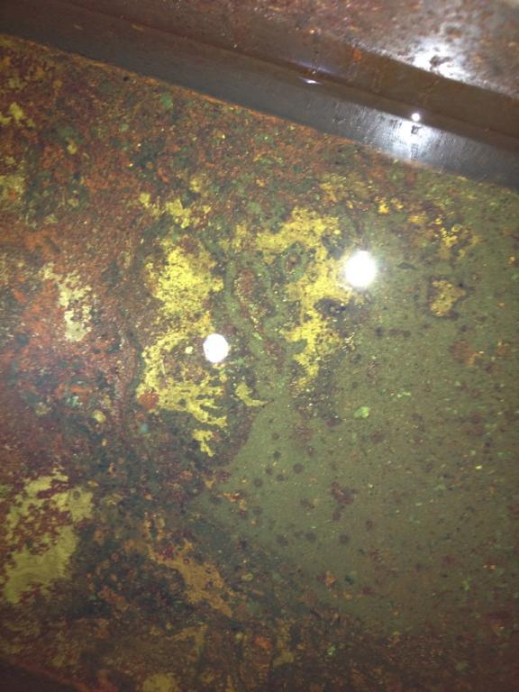

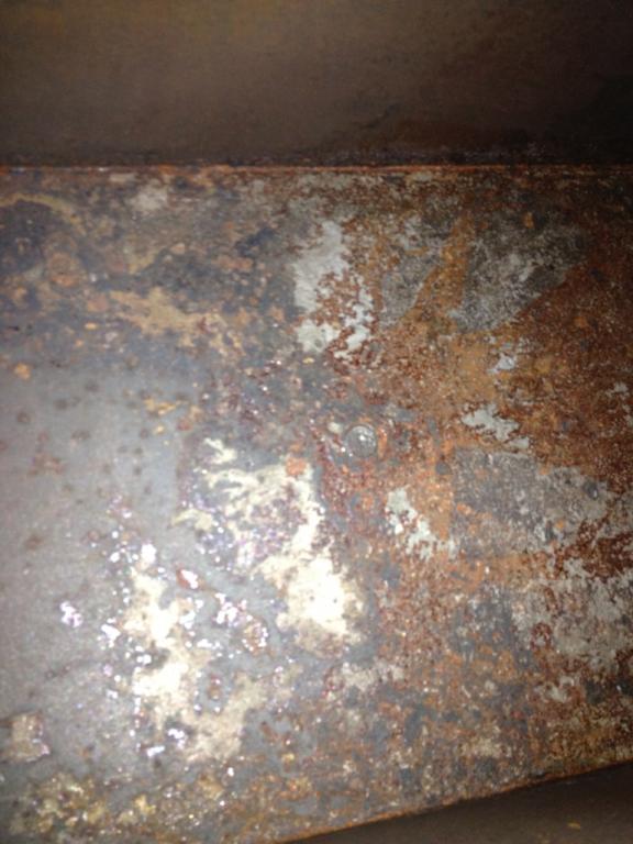

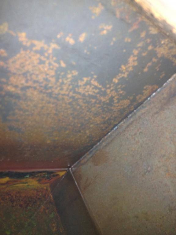

Other than inspecting the tank for issues, does anyone have any suggestions?

I'll do the gauge hole I guess.
