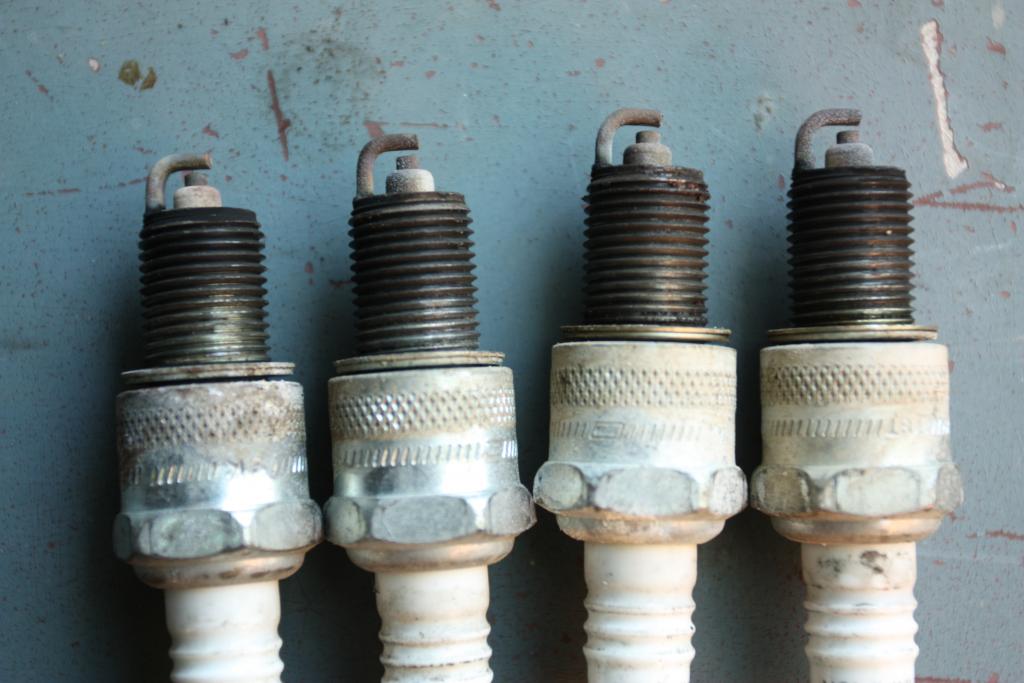

I'm perplexed by an idle issue. Currently have a very persistent miss at idle (read this virtually ever cycle it misses). I've pulled spark plug wires with the engine idling to test which cylinder is missing. Pulling wires 1-3 causes an immediate drop and deterioration of idle. Pulling wire 4 makes almost no difference to idle indicating it is cylinder 4 which is missing. What I have done:

- Spark Plugs - All new plugs; gaps checked; all the same and an even light tan/grey colour; no deposits; no burning/melting; perfect appearance according to charts from manufacturers; swapped plugs from cylinder to cylinder with no change; see picture, the number 4 plug is on the left
