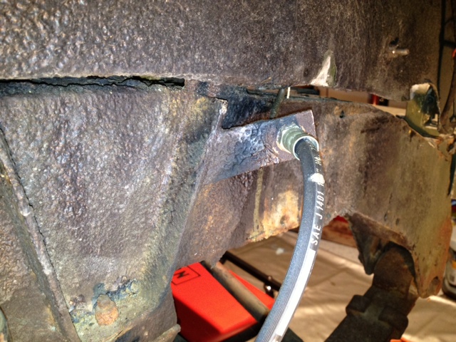

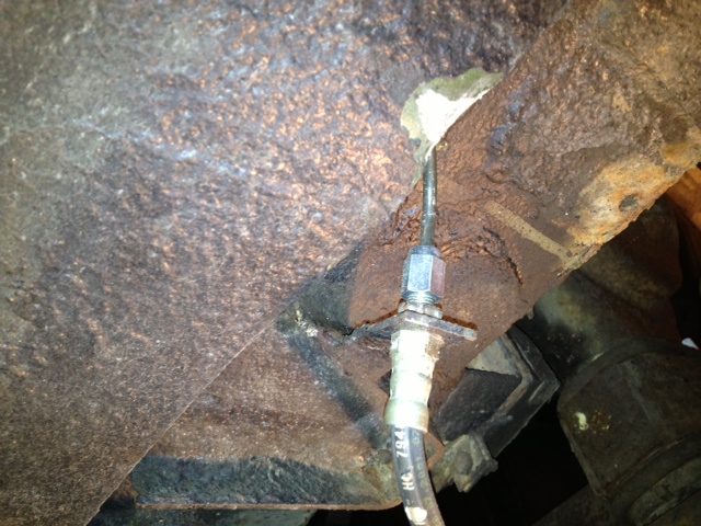

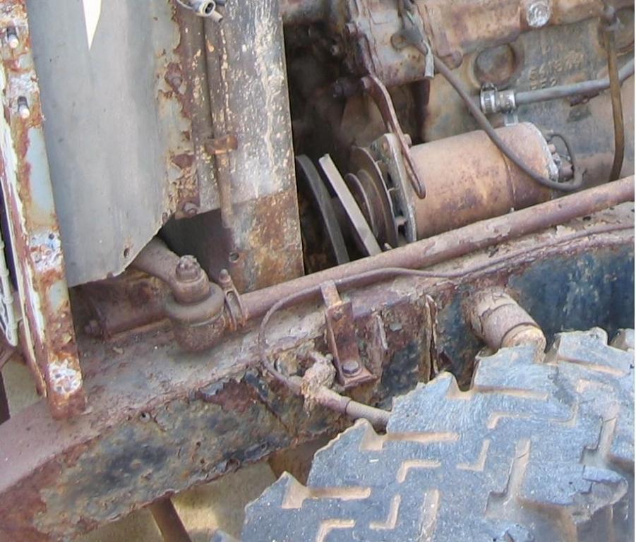

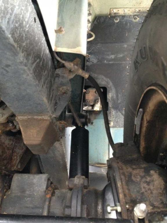

I would like to see the front brake hoses, particularly the orientation and where and how they connect to the frame/ hard line.
Also how long are the late 2A hoses. a 70IIa should be a perfect example.THING 1 - 1973 88 SIII - SOLD
THING 2 -1974 88 SIII Daily Driver - SOLD
THING 3 - 1969 88 SIIA Bugeye Project
THING 4 - 1971 109 SIIA ExMod - SOLD
THING 5 - 1958 109 PU
THING 6 - 1954 86" HTComment
Hmmmm this explains something, my marshland frame does not have that tab that these lines are connected to. Are they part of the frame or a piece attached to it.
Thanks for the picturesTHING 1 - 1973 88 SIII - SOLD
