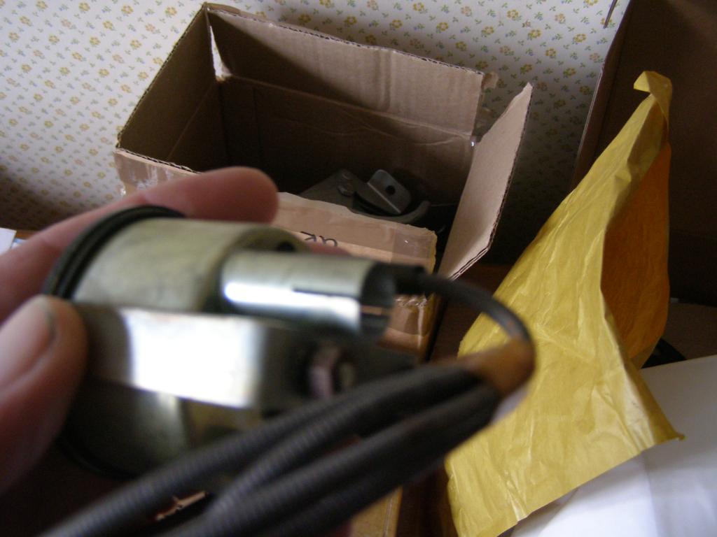

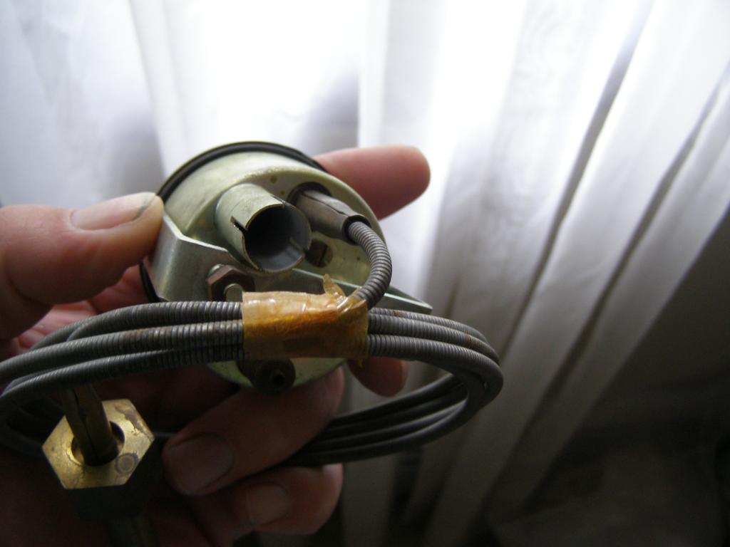

                Here are the pictures that I was either asked for or I promised. The first is the bulb holder:
ID:	167294Click image for larger version

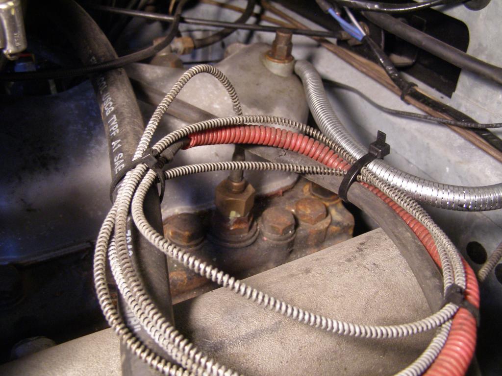

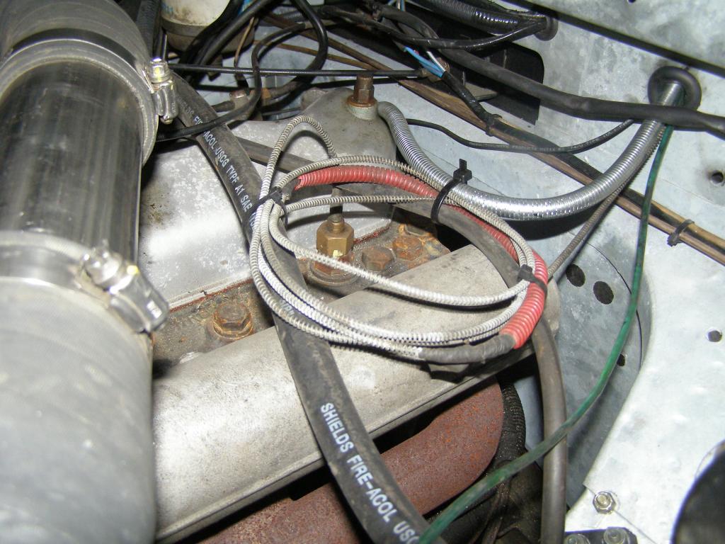

                The next ones are where the capillary (temp sender) tube mounts in to the head
ID:	167296Click image for larger version

                  Hmm, I don't think mine has that, but when I get it apart tonight, I will have to have a look see. Thanks Mark, I never open links when I am checking the forum via my iphone.

                    Most of the early gauges do not have an internal bulb holder like the one pictured - they have an external one which holds the bulb outside of the gauge. The gauge has a window around the outside into which this light shines. It fits onto one of the studs which secures the gauge to the panel. They frequently go missing because they arent part of the assembly. I have extras if anyone needs them.
