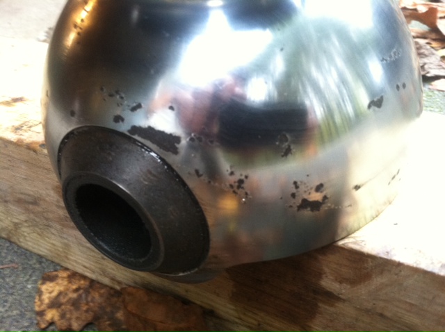

So I noticed the outside inch of my front tires is wearing faster then the rest of the tread. It's something that just started in the last 2-3 months. Jacked up the front and when I place my hands at 12 and 6 I have movement, hard to measure but 1/4" or so. When I place my hands at 3 and 9 all is tight. I've never been inside my swivel balls but know that my swivel ball seal leaks. I ordered new swivel ball seals, wheels seals, inner and outer wheel bearings and took the left side apart today.
So far all my wheel bearings look good so i'm wondering if my railco bush or my bottom bearing might be the problem. I have some top and bottom play at my swivel ball housing. I'm soaking the bolts with WD and plan on taking the housing off next.
What sort of wear should I be looking for when I get to the railco bush and the bottom bearing?
Thanks pb
