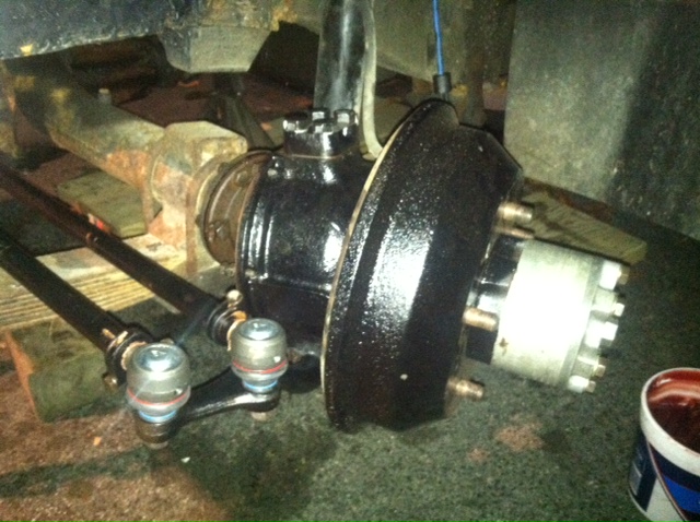

                Put everything back together, and had a successful test ride. The Mule is already back to work, hauled about 1,000 lbs of fire wood this afternoon. Going to start researching tires and get those on. Think I'm going to have the shop pull the old tires off so I can paint the wheels then put the new ones on once I get the wheels looking nice.
                This was my first swivel ball rebuild. A few notes for the next noobie.
                1) Swivel balls are not handed (left/right) but they do have a top and bottom. When my new one came in I jumped on it and installed the railco and bottom race. As soon as I torqued down the steering arm bolts the swivel would lock up even with the railco bolts finger tight. After about an hour thinking about it I broke it back down and compaired it to my bad swivel. Thats when I noticed a slight difference top and bottom. Luckly I was able to get the new railco and bottom race back out and switched. As soon as I did that all was well. I was advised to use a brass drift as it's softer then the metal your banging on. Think thats what allowed me to make the change with out any damage to my new parts.
                2) If your ball joints spin and will not tighten up hit them with the impact, it spins faster then the shaft can and zips the bolt right on.
                Thats it, here is a pic of my work. Thanks for the help. Next is a new radiator and full exhaust.
