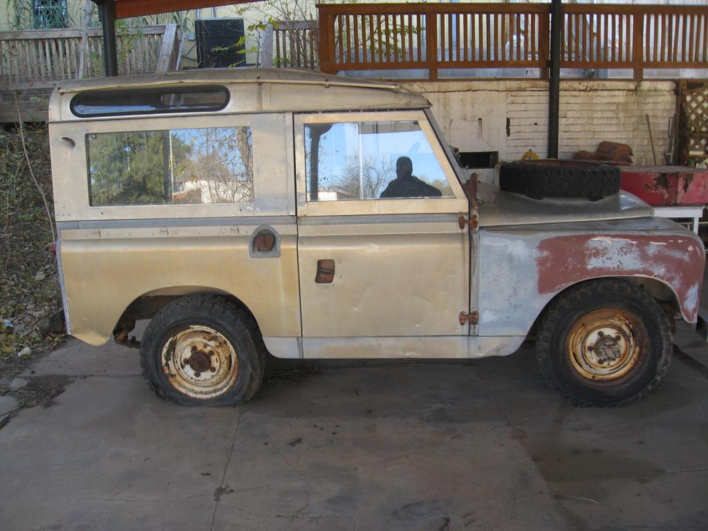

    I just purchased a 1961 land rover 88 station wagon. I think it's a 1961. I need to check. My question is it has original 16" steel wheels that have bias ply tires with tubes and there falling apart. I have found a nice used set of 215 85 16 radials. Do i still have to use tubes on these old rims? Any help would be appreciated. Thanks

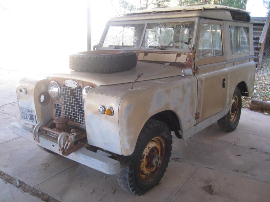

        Not sure what i am going to do with this rover. Just picked it up and i want to get it a little more mobile. Hopefully will get it running in a week or so. Also is there anyway to use VIN to find out any info on it? 144004452

          Question 1: I would use tubes. Make certain they are heavy duty tubes. Standard duty tubes will rub and fail.
          Question 2:http://www.clifton.nl/index.html?calvin.html.

                I am pretty dang sure there the original wheels. They look to be a 2 piece wheel and are pop riveted together. Thats the reason i think most of these have tubes in them. But I was not for sure. Just trying to see what everyones views if i could get away with out using the tubes and tires still holding air. I am just wanting tires to stay aired up so it will be a little more mobile, plus just in case i get it running i could drive it a little. Trying not to put a lot of money in it right now since I am currently working on a 1966 88.Click image for larger version

                  --I don't believe that '61 88s came with 16" wheels.
                  --Radial tires with inner tubes will require radial-compatible inner tubes or the tubes will fail.
                  --The wheel centers might be riveted to the outer rims, but they sure aren't pop riveted.
                  --Different rim part numbers are tube-type rims, others are tubeless-type. Easy to google once you have found the p/n.
                  --Tube-type rims can often be used with tubeless tires. If they don't leak, then they're fine. My spare is a radial tire on a tube-type 16" rim and it hasn't lost 1psi in the year that it's been there. You never know till you try them.

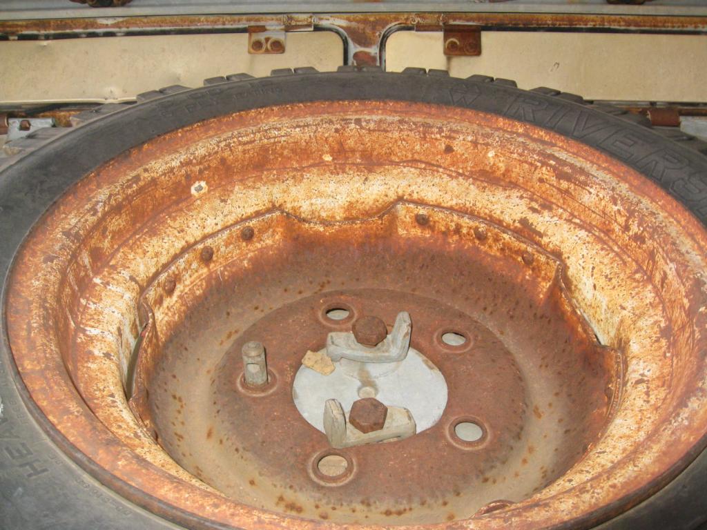

                    pic of one spare, there 6 wheels total

                      Part # on wheel as I can see is 231601. What is hold the two pieces of the rim together

                        I have never run tubes. Make sure the rims are cleaned of rust. Tubes heat up by rubbing inside and are a pain to field repair. When I get a puncture, I can plug it with a 20 dollar repair kit from wal-mart without taking the wheel off the car. For something more serious is what the spare is for. The valve stem will be the old larger FORD type. Rivetted rims are used on modern tubeless construction so going against that doesn't hold air with me. If worried, you can smear some of your favourite epoxy over the rivet heads inside the rim if you're worried. Check for leaks with soapy water once they are mounted and you will soon find out. I run tubeless 235/85/16's on my series 1. they have never leaked. As for the safety bead missing, that safety bead doesn't seem to be much help for boy-racer tires when they come off. I can mount/dismount/balance myself so I did it this way. As for your own piece of mind and legalities involved, is up to you.

                              231601 wheels are 15" not 16". Rivetted wheels can be run tubeless. When they make these things they heat up the rivets red hot and they are whacked with a giant press. The rivet shrinks as it cools pulling the two pieces together really tight. That's how they used to build ships long ago as it makes a very good seal.
                              Yours look like they have some amount of rust. I wouldn't bother with new tires until you've had the wheels refinished.
