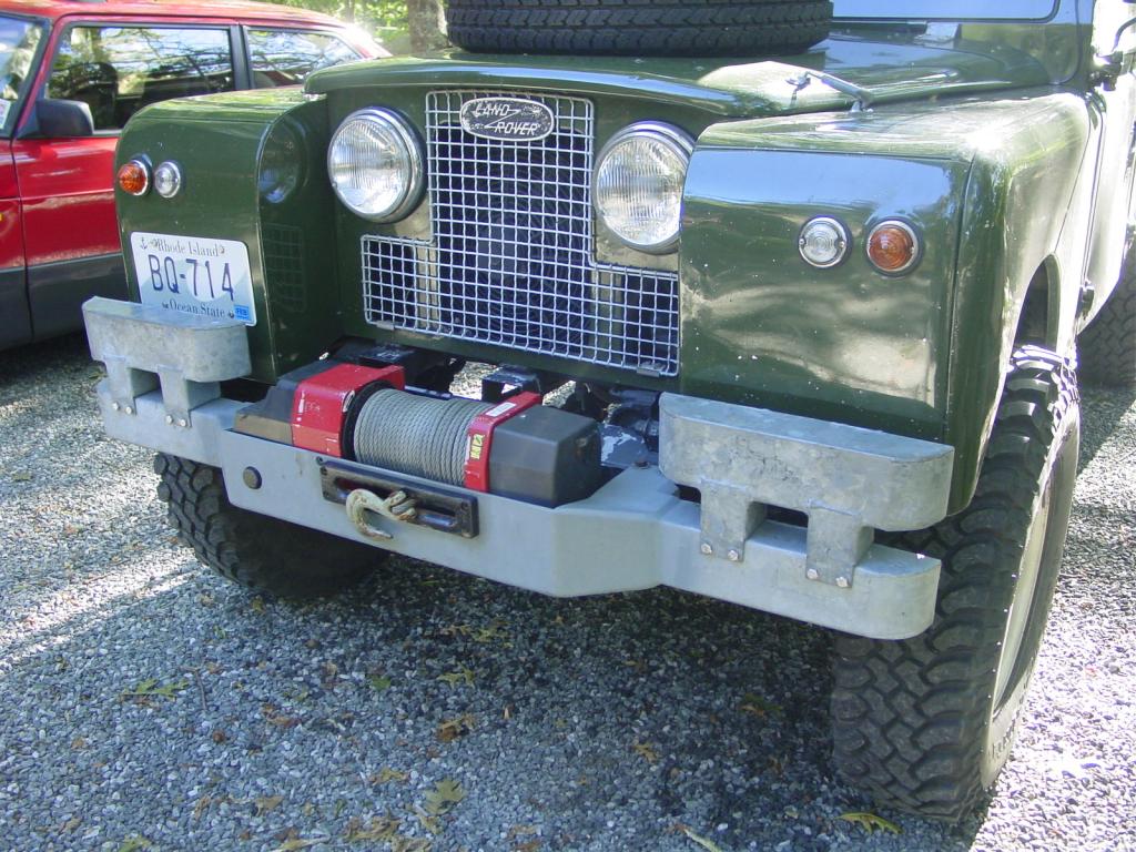

        I have been very happy with BF Goodrich mud terrains on my '62 109. I have near 70K on them and still have tread left. Mine are the KM1's (no longer manufactured) but have heard the KM2's are just as good. I plan on getting KM2's when I need replacements. This is what they looked like with ~ 65K on them...

          I too am looking for tires for my 63 109. These BFG's look great. What size tire and rims are you using? It looks like a lot of offset.
          Terrific winch choice. I have one on my Van. Its been used for everything from lifting shop joists to moving log cabins.
          It will work all day with no trouble.
          Has any one used the skinny Gateway TSL's??
          regards
          jim
