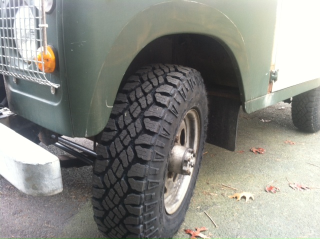

            1970 IIA 88"
            Installed 4 215/85-16 Goodyear Dura trac's late last year. They have the winter snow flake rating, made in USA. Think I paid $800ish for the set. I've been very pleased with snow/ice performace and mud/light off road. As for noise the Rover covers up anything the tires might make.
Name:	new tires ft view.JPG

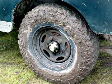

                    Originally posted by Cevan
                    How does the offset of the Disco I rims compare with the stock 16" rims. The rims on my IIA have less offset than my buddy's series III 16" rims and I don't want mine to look like a mail truck. I would like more offset and a wider rim.
                    The Disco I wheels have the extra width inboard so they do not stick out of a Series body.
