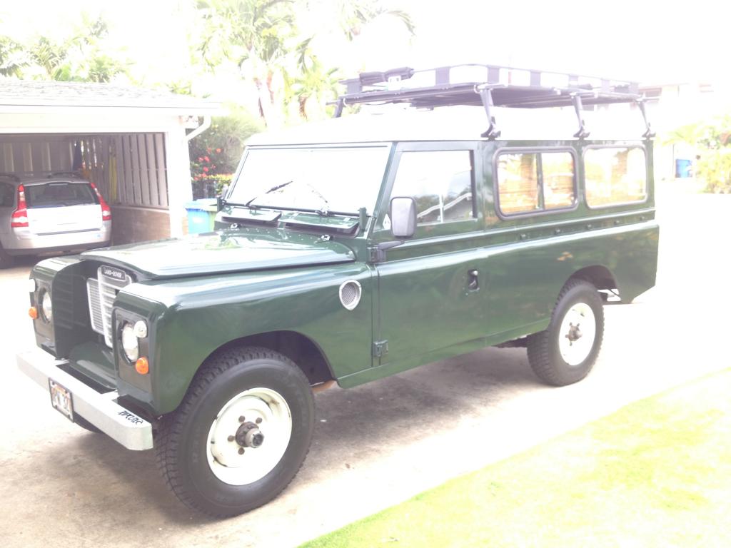

    Aloha,
    I am a new owner of a 1983 Series III LWB and love it so far. It is a re-built and has about 19,000 miles on it since being redone. It has been a bucket list to own one and I have not been disappointed.
    Now for the points. I know nothing about cars. I can change the oil, and check fluids. That is about it.
    Here are the issues. I am having issues changing gears. To use someone's words to describe, " it is like trying to find keys in a oil can with a broomstick, blind." Bottom line. It feels sloppy. Is this normal? In reading the posts, which I am truly greatful for, it can be a easy fix, or a major re-construct.
    Any advice would be greatly appreciated.
