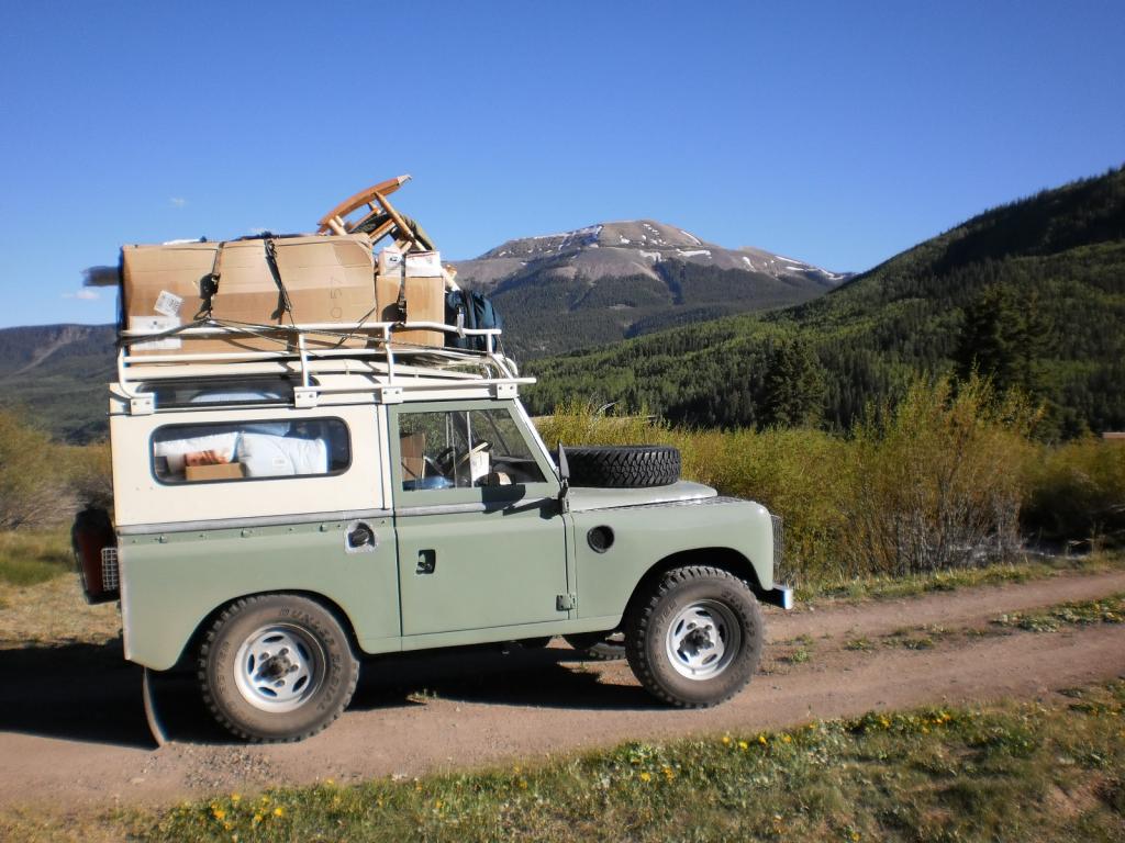

Steel wheels should fit. Easy enough to slap on on to make sure.Jason
"Clubs are for Chumps" Club president -
RRCs never had steel wheels to my knowledge (except for the early Rostyles). They all came with alloy spares, at least the NADA ones.
Those appear to be Disco 1 spare tire wheels. This was a popular switch in the 1990s, for some unknown reason.Last edited by o2batsea; 07-30-2013, 09:45 AM.Comment

Seems like they are 7s. They might be 8s. I have one I was going to use as a bonnet spare. It was so tall I felt like I was peering out the gunner's slot of a tank.© 1974 Apis Mellifera. Few rights preserved.Comment
Those are not RRC wheels. They are Disco I steels that were introduced in 1989/90 with the Disco I. The steel in these wheels are the same thickness as Wolf rims making them great HD alternative wheels for series vehicles. The downside with the extra thickness is that the wheel studs are a bit short which does create a safety concern. If you regularly check your wheel nuts then no problem, but there has been a few accidents in England where the wheels have come off from lack of maintenance. I'd have to check the set in the garage but I'm sure that they are 7" wide.

I expect it was to fit wider tires and still keep within tire mfg specs.
Also I was told by someone who worked at a POE that the Discos were actually shipped over with steel wheels then switched to alloys, so the steel ones were cheaper to find than old Series wheels in good shape. I have no idea if that's true or just something the person was mixed up about.Tom Rowe
