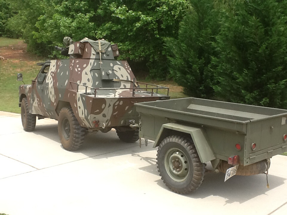

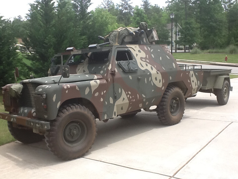

          All the photos. Will post some more when it arrives Thursday.

              Thanks for the pix. I'm looking forward to having a "cabbie" in it.

                No interior " traxmark " upholstery? Mine, in sad shape, has the tan vinyl with foam insulation backing. Without it, you can not touch it after it sits in the sun, let alone drive it when temps hit 100 deg. I have been thinking of removing it and spraying snakeskin brand insulation coating or bed liner.....
