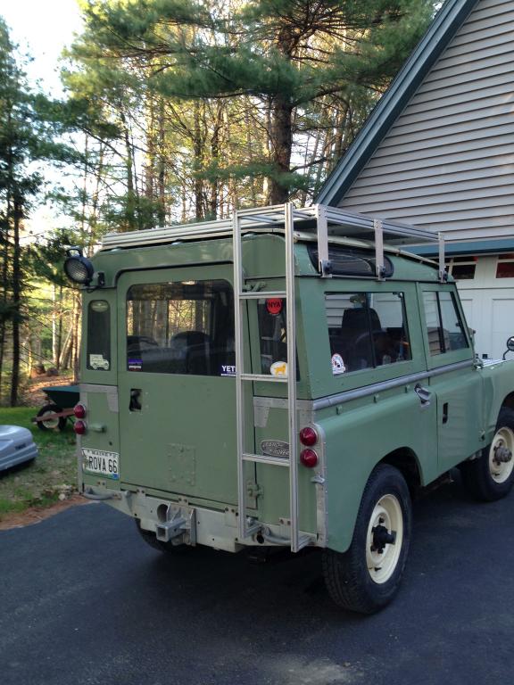

            #6
            Now you have seen a pastel green one.

              #7
              Is the wheel barrow to haul all the spare parts in?

                #8
                Always need to be prepared.

                  #9
                  Well, maybe. There are lots of clues that lead me to think that it was not a wagon to begin with. It has been painted at least once since new, so there's no way to tell if it came from Solihull as a wagon or a regular.
