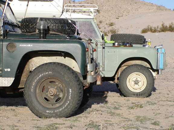

K&N filters are used by off road racers who rebuild their engines between races but are otherwise not the best filter to use for off road driving where the dust levels are high. The stock Series filters are a lot better for clearing dust out of the intake air.
If you want the best of both and are willing to do the work you can do a K&N on pavement and switch back to the stock filter when you leave the pavement.
The K&N fits best on the end of the stock system's steel elbow.
If you want the best solution look to see what commercial earth moving equipment and tractors are using then find something with the same air requirements as your engine that can be made to fit.
My V8 powered truck uses a Donaldson paper air filter with a prefilter in front of it. All chosen to meet the airflow requirements of my engine.
You can use the formula below to find out how much air your need and choose a filter or filter & prefilter that operates in that range.
Teriann Wakeman_________
Flagstaff, AZ.
1960 Land Rover Dormobile, owned since 1978
My Land Rover web site
TeriAnn,
Your pic of the K+N on the steel elbow is exactly how I have used on two series trucks. My current one is on my 69 Bug Eye with a 34ICH. I agree that on extremely dirty talcum like dust, the oil bath is good, but for most conditions and certainly on road, the K+N is excellent.
RobComment
