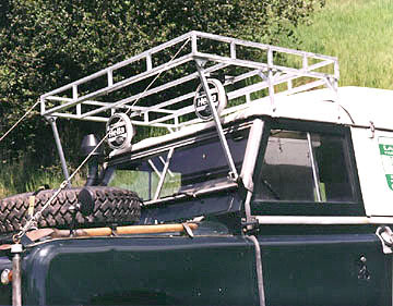

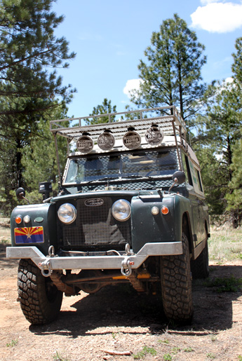

                    Mine (2 Euro beam, 2 fog) are tucked in on the underside of the roof rack well protected from damage, They are aimed so that there is very little light on a bonnet mounted spare.
                    A decade+ earlier picture back when I just had 2 lights showing the light location better.
                    I have my lights mounted with the fog lights on the outside pointed slightly diagonal to provide a wider light periphery and the euro beams pointed to the front for distance viewing. They are fed by a high amperage relay which is fed by a 40 AMP fuse
