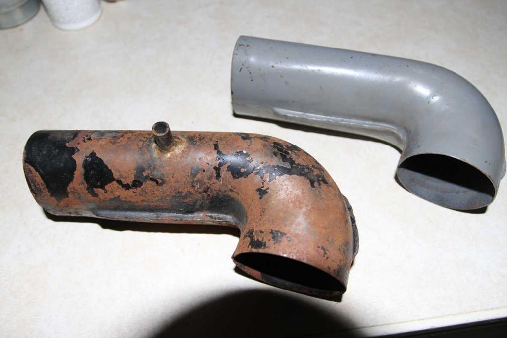

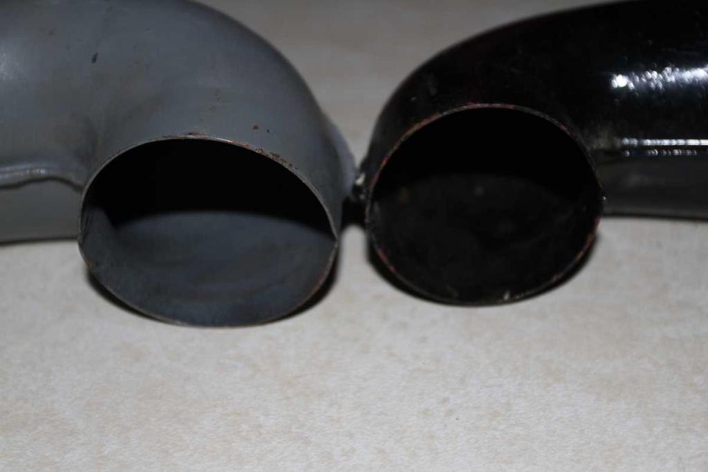

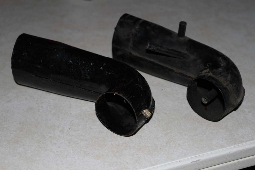

        Note that there are at least two different diameters at the carb end of the elbow, and several variations of the elbow small hose tubes.

              The smaller elbow is 2.25" in diameter, the larger is 2.5". There is a rubber tube that connects the carb to the elbow. I know the Weber carb has a metal adapter that slips over the small diameter carb opening in order to fit the large diameter rubber tube and elbow.
