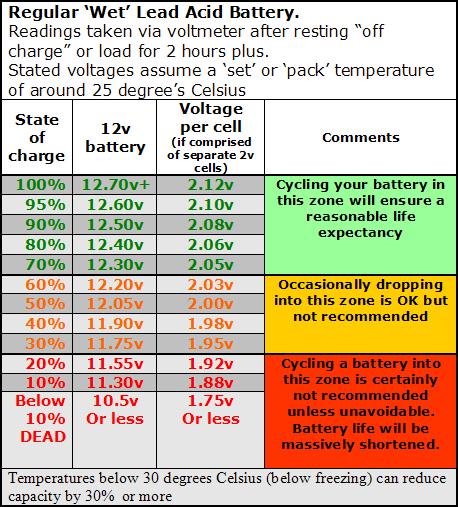

Given the 0-20F weather we have had endured for the past few months, (during which my Series has rarely started) should I take a battery voltage reading of 10.75 as a sign of a dead battery in need of replacement? Few lights come on when the key is turned, and the battery has is of indeterminate age, it was in the truck when I got it three years ago.
