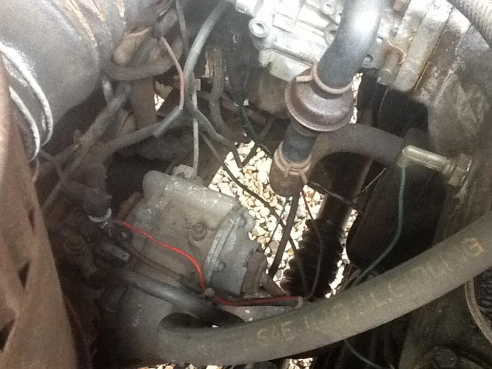

Can anyone direct me to a store that sells the British brake line fittings or hoses? I may have found a shop to rebuild my remote brake booster, however I need to take it out , ship it, and want to drive it while booster is being repaired. I need a hose/ fitting to go from the old style brake master cylinder directly to the junction block, or a hose to connect both ends at the point where the booster was removed ( a simple brake fitting union? ). Thanks.
Our host would be my first call as they have just about anything. If not...........
http://www.pangolin4x4.com/Comment
I don't have the answer for you--In fact, I recognize almost nothing from your picture--but using this resource, you can probably get it figured out:
http://store.fedhillusa.com/technicalhelphowtopdfs.aspx
Oh wait--I just had another look. I recognize the front drive shaft and the steering gearbox arm.--Mark
