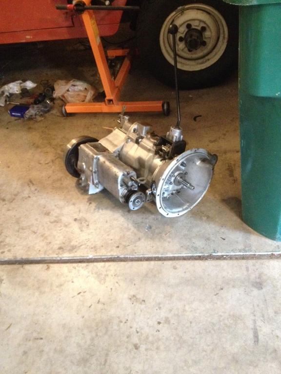

A little update. Things are going together well. One thing I would point out to those going this route is to order the various shims at various thicknesses. Just do that, because they are inexpensive. I didn't think of ordering more slowdometer housing shims and I need some. Also, I can see no way those shims and the slowdometer housing can be sealed. I will probably "caulk" it with high temp RTV or something. Another poor design "feature."
One question to those experienced. After assembling the main gear box, I notice the shifting between 3rd and 4th is "heavy." I lubricated the syncro and assume that after a bit of running it will loosen up. What say yee?
edit to add: I am not working on this 24/7. Maybe a couple of nights a week after work. I am on the home(r) stretch and might even get it in this weekend...or next.
