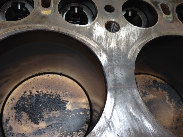

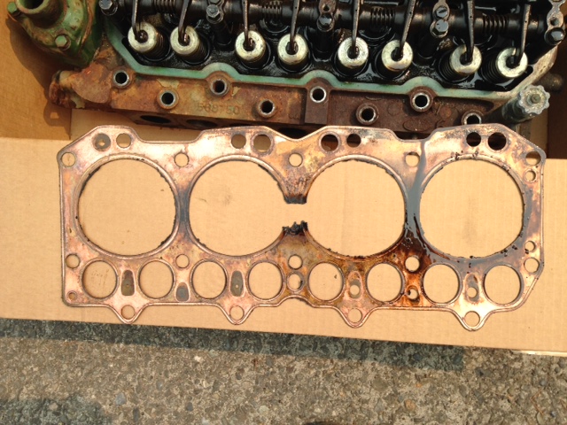

    Hi, I recently bought a 64 2a that had sat for 10 years, very similiar to a '69 I used to have. Relatively rough running when I picked it up, and a compression test showed 145, 90, 90, 145, so was pretty sure it was a blow head gasket at least. Sure enough! From the look of the head and the block deck, it looks like it's been happening for a while too...
    reinstalled everything, and didn'r run that great, so chasing through the fuel lines, filters, sediment bowl, carb, spark plug wires, plugs, rotor, cap, etc... good fun!
    Anyone else have this occur? Anything I should be watching for in addition to this that may have occurred as a result, or led up to this?
    Thanks!

    I have had two head gasket failures at the same location on two different trucks. Check the head and block surface to see if they are flat. Running for an extended time with the gasket blown can wear the surfaces.

      Have you done a new compression test since the gasket was replaced? That would show some indicators.

        Definitely some wear on the block... but I think within tolerance (I need to check spec's on that).... honestly, I should just have the head machined to ensure it's not something I need to repeat... once I get it running OK, I will.
