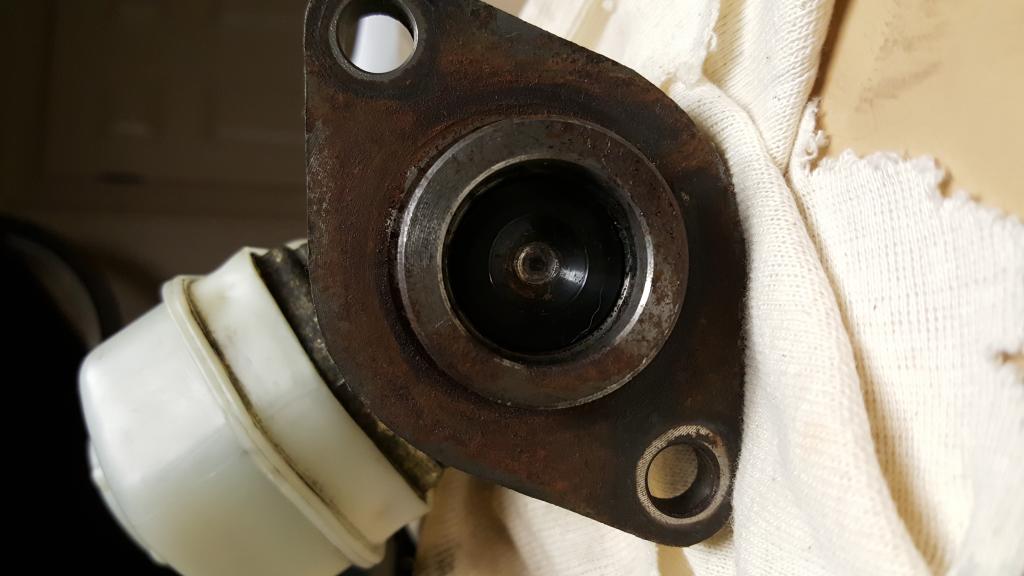

I have been debating if I should rebuild my master cylinder or just buy a new one. I want to learn as much as possible, but I can’t figure out how to get this thing apart. I do not see a snap ring in the back. Does anyone have any suggestions or a step by step on how to take it apart? Thank you in advance for your help.

I think if you look closely at the bore in this photo, you'll see that instead of a snap ring, they use a spiral ring. The end of the ring is angled so you can pry it out of the groove with a small flat screwdriver. Once you get it started out of the groove, you can work the helix out of the groove till it's completely free, which will allow you to remove the guts.

Looks like the retaining clip is actually not there.
You can get the plunger, etc out of the cylinder by taking an electric tire pump (or air compressor) and pressing it up against one of the two brake pipe holes/fittings - press hard so the air is forced into the cylinder. Block the other one with your thumb. That will be just enough pressure to get the cylinder to "spit out" the plunger and internals.1968 Series IIa

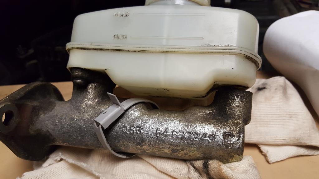

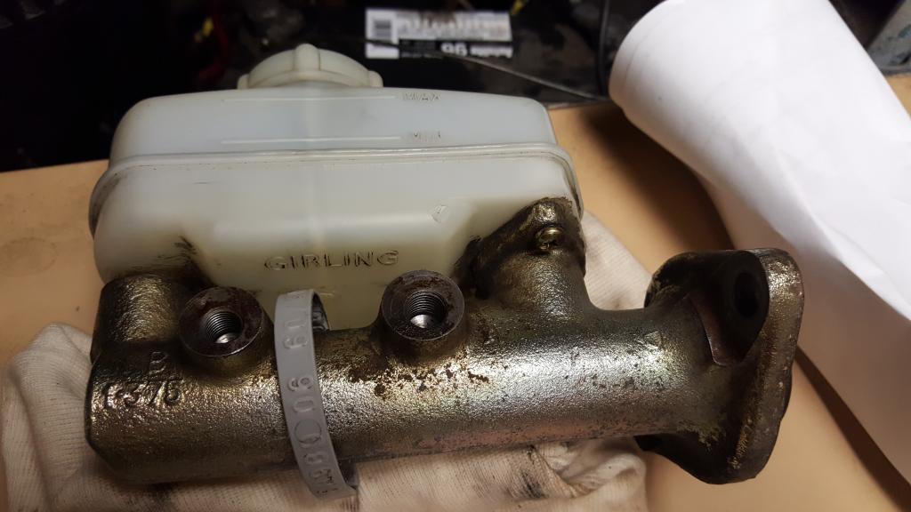

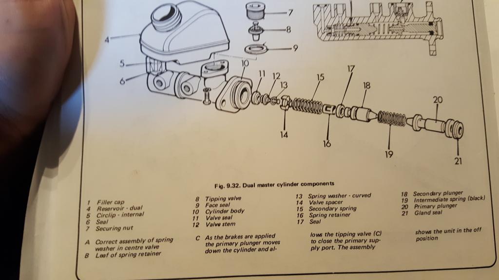

I am making progress, but I am stuck again… In the directions for a Dual type MC step 14 says to lift the reservoir but I can’t get it off the MC. Looking at the attached diagram item 5 says there is an internal circlip. How do I remove the reservoir? I am afraid to pull to hard because I don’t want to crack it and I don’t want to try to pry it with a flat head because I don’t want to puncture it…
But your directions say to simply pivot it. Maybe that is the case, but it wouldn’t solve the problem to access number 6 in my diagram.
Thank you all so much for your help!!1960 Series II 109 Station WagonComment

You definitely need a factory Workshop Manual...
Here's the rest of the page (from the factory WSM) that I posted in response to your earlier query:
