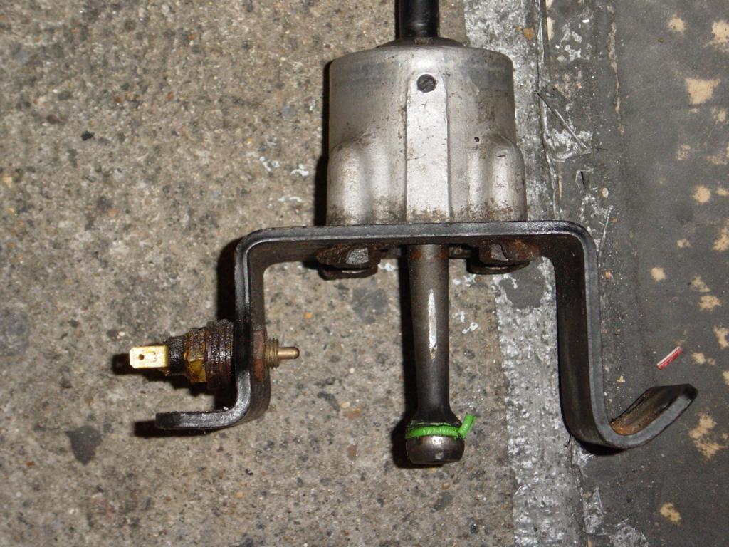

                This is from a Series 2a but the S3 is very similar. make sure the washer (in green in this photo) has not broken into pieces and lodged into the gear selector. I had the same problem as you and this is what was causing it

                  Originally posted by Manny
                  [ATTACH=CONFIG]11386[/ATTACH]
                  Thanks Manny - that is helpful. Hoping to dive into this over the weekend
