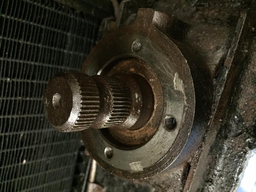

        Colin, this photo is very helpful. But it looks like you have been able to go a layer deeper than I have currently been able to. Here's a shot of what mine looks like:
        Is it the thrust washer you mention above that is still in mine? If so, is there a way to remove that washer without removing the relay from the chasis?

          You are correct in that my picture is shown without the thrust washer. The washer is bronze I believe so I don't think a magnet will work. It's just sitting there, but with no room to dig it out I'm not sure how you could go about removing it. The bolt holes can be used to fill the relay. If you have a top on your oil bottle like the one in my picture you could stick that in the bolt hole and squeeze. I've heard of guys using an oil can to force the oil in.
          If the oil doesn't go in easily, try another hole. The bushings under the thrust washer are split. If you find the right hole that's close to or at the same spot as the split in the bushings I would think the oil would go right in. Otherwise the oil will hit the top of the bushing and have to creep down into the body of the relay. Hopefully you understand what I'm trying to say.
