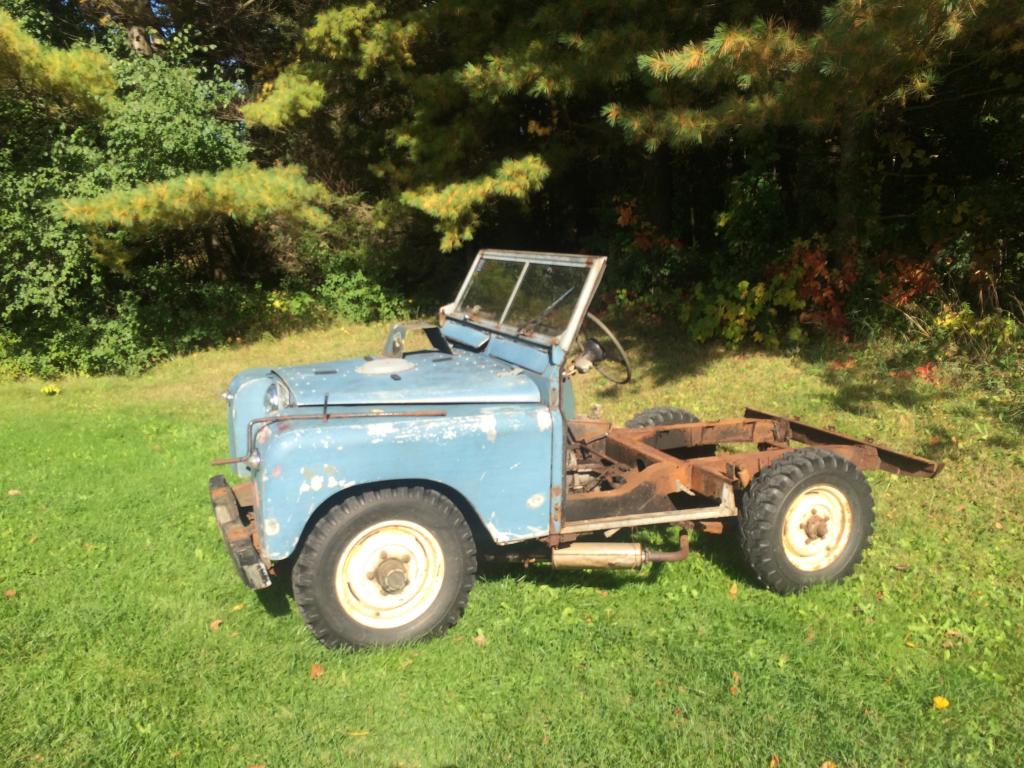

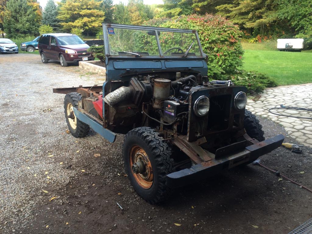

    Story goes as this, it was given to me after plowing snow for 25 years. It is extremely rough, I haven't got a huge amount of money, the idea is to get it functional, safe and good looking and get it onto the road. First things first The frame is garbage everywhere behind the seats and everything in front of the front axles with a few rough spots in between, Don't have money for a new frame and I'm real handy with a welder. I've got it mostly stripped, was planning to leave in the bulkhead and drivetrain and do all the welding and cutting around that. We'll see how it goes. I've got some pictures I'll add later on.
    1966 Series IIA
    A Little rough around the edges... And everywhere else.

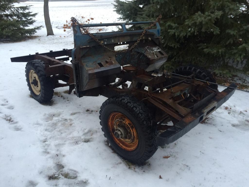

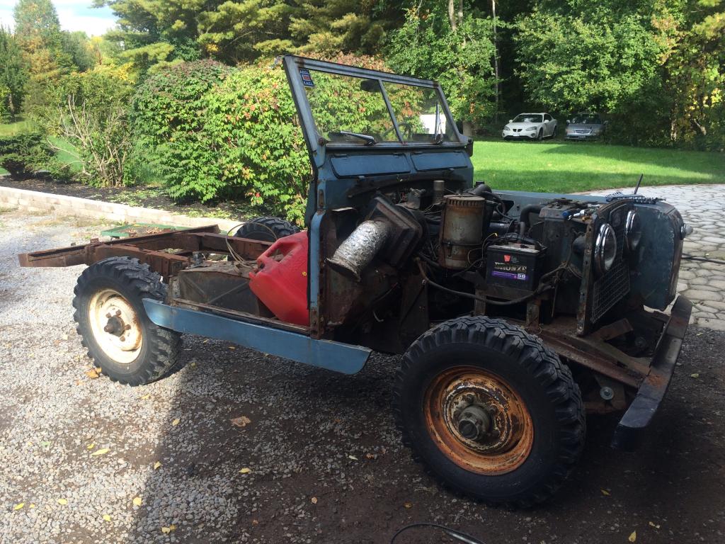

    As promised a few pictures. Going to start chopping at it soon but I need to come up with a game plan first. Need to find the solidest parts of the frame and decide where I can weld and tie into it without blowing through.

      Certainly has potential. Take a good look at the front spring horns...looks like someone may have already did some repair, or maybe that's part of the plow rigging? Also take a good look at the rear crossmember, typical problem area. How do the bulkhead & door pillars look? Keep us posted on your progress. Good Luck!

        Yeah the rear crossmember has some rot at the bottom on both sides where it meets the frame rails. It's the least of my worries, the entire frame needs work.

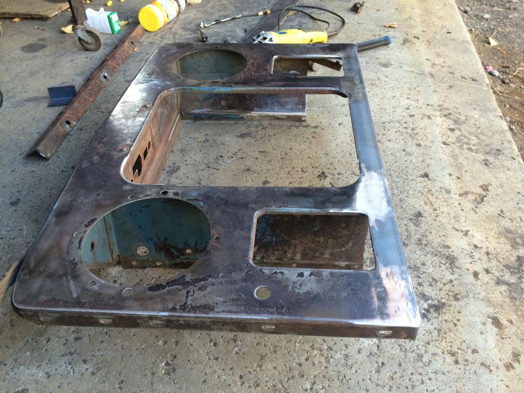

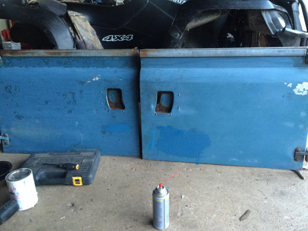

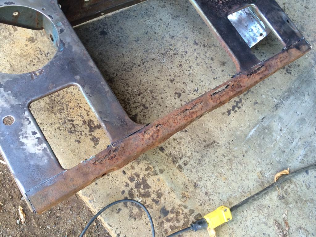

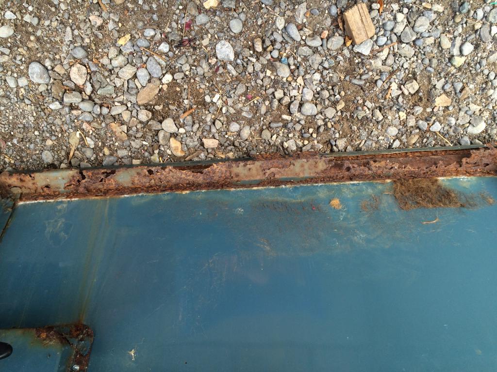

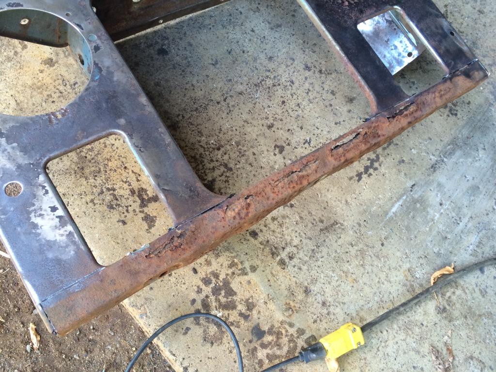

                        Started going through the motions. I've got it all apart except for the bulkhead and driveline, the breakfast plate got some repairs and it's ready for paint, the lower door frames are next then it'll be tackling the bulkhead, hopefully by that time I'll be ablke to roll the thing in and start chopping at the frame, I realized a little while ago that maybe the head gasket was blown then all of a sudden it got really bad and all the coolant drained into the crank overnight, did a compression check and have between 120-130 on all except one second from the back which is 80psi. Also what do you think of my paint colour, not quite the same but the paint on there isn't original and it covers up the marine blue that it had before as you can see in some places and inside the vehicle.

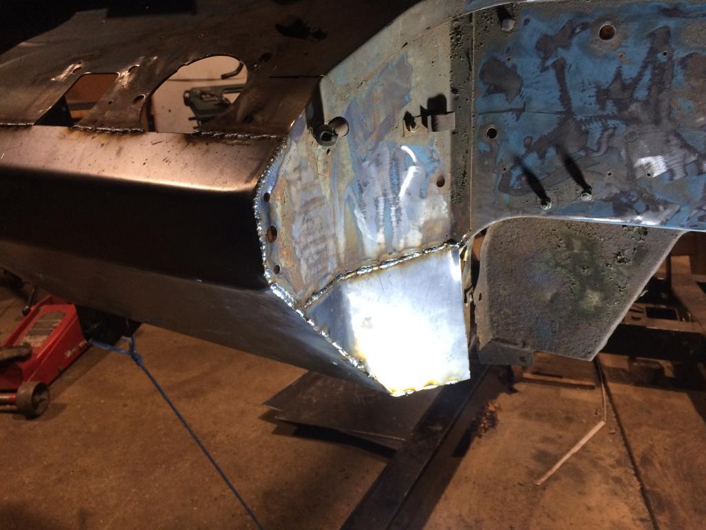

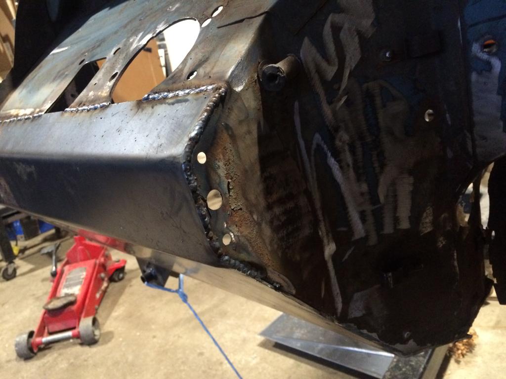

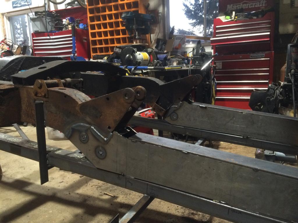

                          I've gotten busy with other projects but I'm back at the Rover now. It's fully torn apart now and I started into the Bulkhead, new Pillars and feet and now I'm most of the way through getting the new footwells into it.
                          1966 Series IIA
                          • mrmoose
                            Low Range
                            • Sep 2016
                            • 35
                            #14

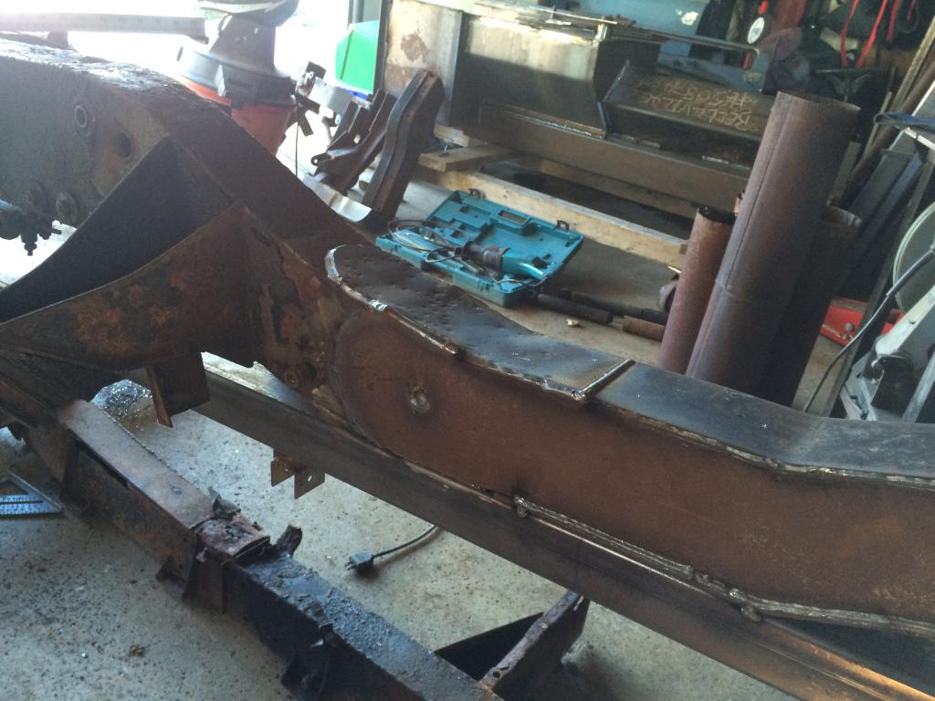

                            Some pictures of the bulkhead and frame.
                            I'm not quite finished with the bulkhead yet, the frame needs a few more outriggers and it's done. Then I suppose I've got to finally decide on paint and start bolting it back together.
