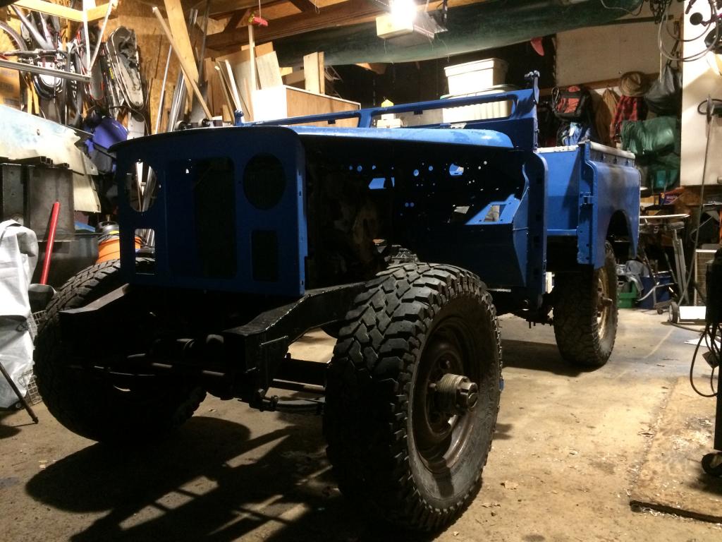

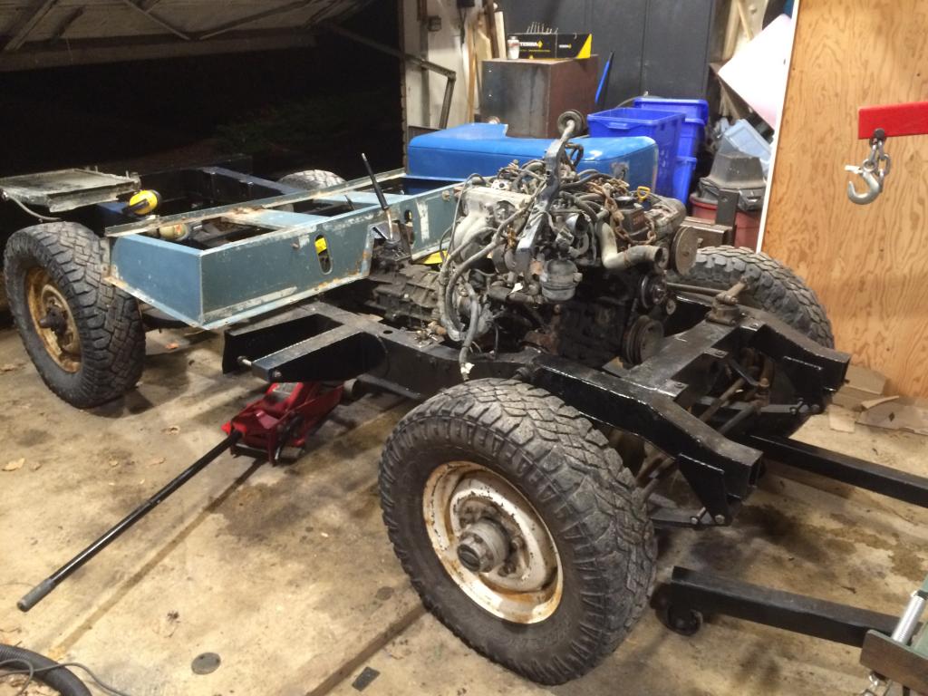

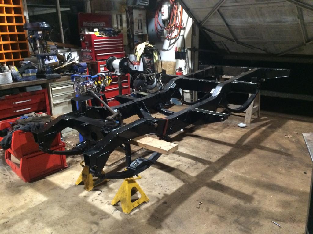

            Sorry I haven't been around in a goodly long time. I got the frame buttoned up and then needed the garage space for a few other projects and it got pushed off in the shed. I've dragged old Rosie out now though and after a little planning and finding a cracked head and seeing the cost of new swivel balls and just rebuilding in general of both axles I've decided to do a driveline swap. The donor a 1991 Toyota pickup was happy to give up it's 22RE mated to a w56 trans with what I believe is a chain drive transfercase. I was planning to use the rear axle and find a suitable front but if I can find a truck with a front narrow enough I might grab the rear as well to avoid having to put new gears in one. The front is a passenger offset and the rear is a center pumpkin. I've got the motor mounted in Rosie and since it's such a long transmission will have some playing to do with the transfercase shifter, had to pull the fan too and will be using an electric fan in front of the stock Toyota rad. Since I've got the parts I'll be doing a powersteering swap using the Toyota pump and box. Hopefully whatever front axle I find has discs and I plan to do a servo swap too.
            I'll throw in a few pictures to keep you guys happy. Started painting the tub and the bulkhead and only need another warm day or two for the final coats and then they can go back on. so far the actual amount into old Rosie is right around $2000 I think maybe a bit more but I bought a bunch of parts planning to use the original motor and driveline and they will go with the motor and axles when they are sold.

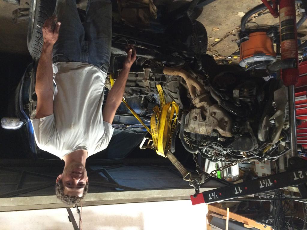

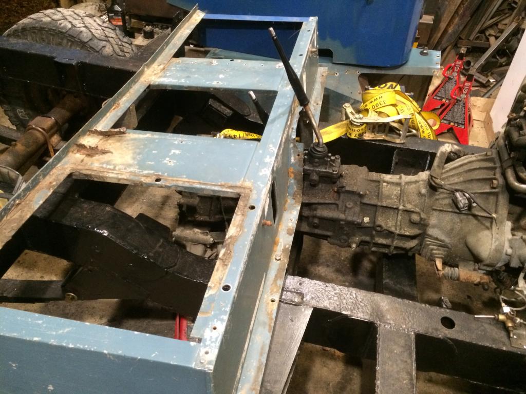

              Not sure why this picture is always upside down, everytime.

                What engine and transmission is that? Was the Rover one no good?
                • o2batsea
                  Overdrive
                  • Oct 2006
                  • 1199
                  #23
                  Just saw the post re toyota swap. Should speed things along over refurbishing all the Rover bits.
                  • erik88lr
                    1st Gear
                    • May 2016
                    • 126
                    #24
                    [ATTACH=CONFIG]12482[/ATTACH]
                    It's the powers that be way of telling you that a Toyota engine isn't quite right for a Landy.
                    But if it works for you, more power to you.
                    Enjoy your project.
                    • mrmoose
                      Low Range
                      • Sep 2016
                      • 35
                      #25
                      The powers at be telling me that only the Australians want Toyota parts in their Rovers.
                      The Rover motor had a cracked head, I was planning to use it but I think it will be more worthwhile swapping it out entirely, I doubt it will cost much more to do a complete swap then to rebuild the axles and get a new head with hardened valve seats. This way I end up with a motor thats more powerful, more efficient and easier to find parts for. Not so easy getting Rover parts up in Canada.

                        #26
                        I too was going to suggest waiting for a frame to come up for sale but seeing you were: A. young, and B. capable , I have to say, that frame looks fine, good work. When I was your age neither would I of waited but started welding NOw!!, and it wouldn't of looked as good as your work so press on, revive this thread and send some pics once in a while. I have the last 3 sold on the west coast outside alaska and I wish I had a Series 2-2A just for the all metal dash.

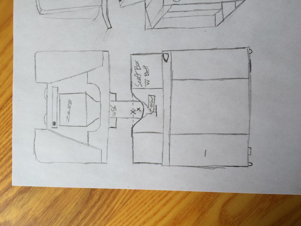

                            Next is axles. It appears the axle from the 91 is 8 whole inches wider than the series axle which I WAYY too much so I'm stumped again. To go with that axle I picked up a front from a 1980 FJ60 but it seems like It's going to be far to wide too. It's hard because I get an idea and go through with it realizing finally that it most likely wont work and it will be hard to get my money back out of it.

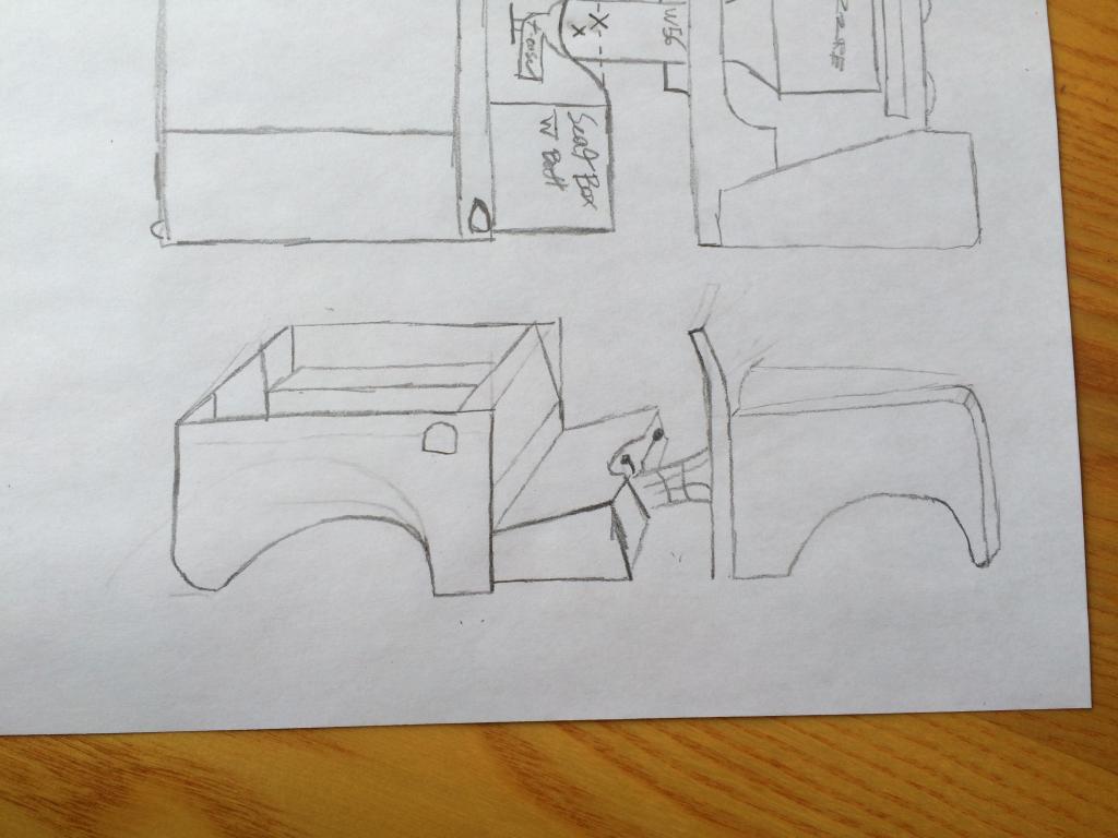

                            I think next I might start on the seatbox. I'm going to make a new box from scratch to avoid cutting up an original one, also i can't weld the aluminum original box. Plan is to only seat two up front, the box will curve back around the shift levers. I'g included a rough sketch.

                              #29
                              ditch the seat box and just make a traditional flat floor and box in the tunnel. That will let you use any seats.
                              • mrmoose
                                Low Range
                                • Sep 2016
                                • 35
                                #30
                                This is a thought that I have been entertaining but I think That I will go with the seat box and keep it sort of Roveresque in the cab. I also want to build and underseat box on the passenger side for the battery and the fuel pump.
