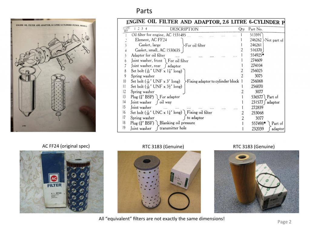

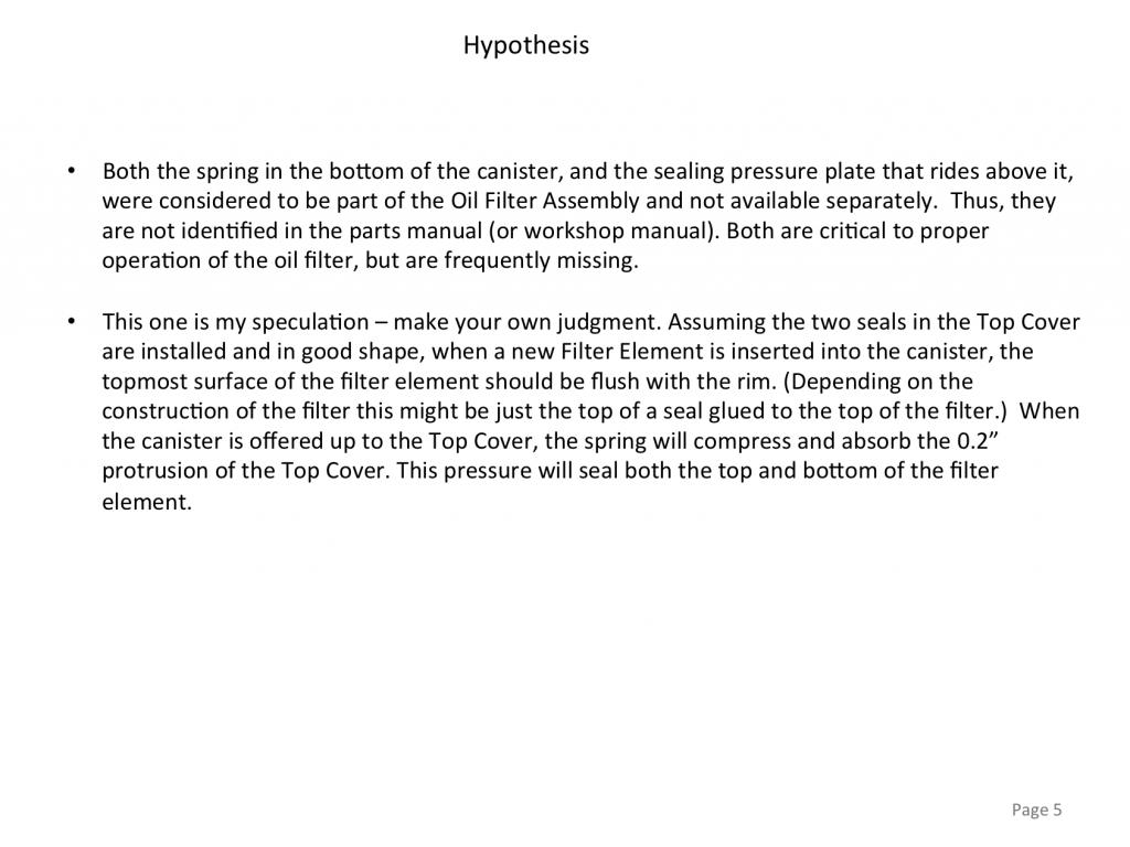

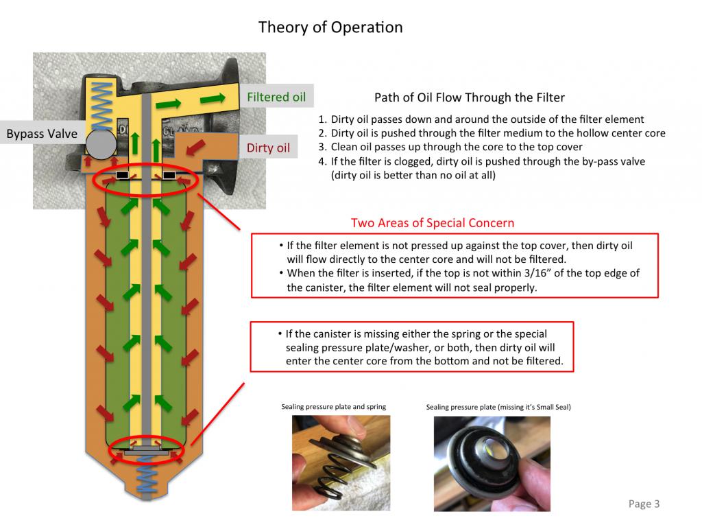

Looking at the parts manual there appears to be a small rubber gasket that should go under the oil filter. When I try to find this part nothing comes up. In my truck there was a spring at the bottom of the filter.
Any ideas? Do I need the spring or the gasket at the bottom?
