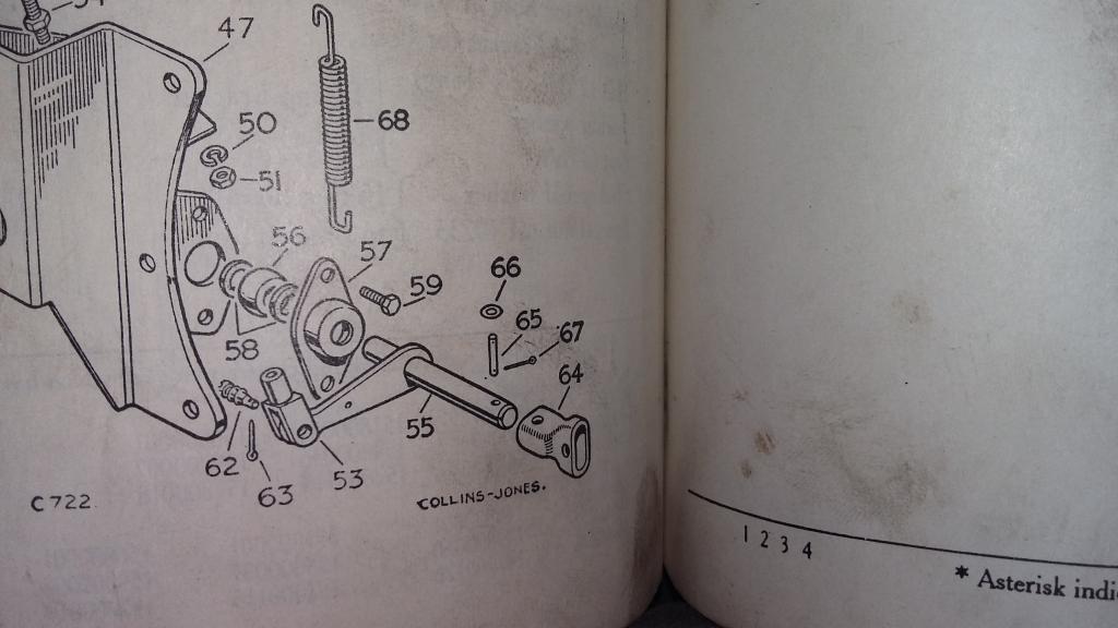

          Check that one of the pins (65) through the couplings sleeve (64) , that transmits the rotary motion to the release bearing hasn't partially broken . If I remember correctly if one end of the pin breaks off, the clutch pedal will feel different and engagement point will change as well . There are two pins at 90 degrees to each other ,one each end of the sleeve. The parts are relatively cheap but its fiddly to get at. The spring (68) was deleted on later models . Picture out of early S2A manual For info Clevis 53 is connected to the hydraulic slave cylinder .Click image for larger version

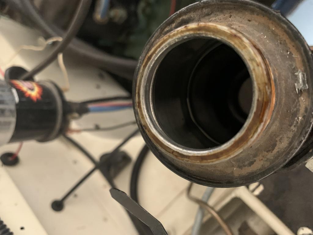

                  ok, checked the reservoir and sure enough, its almost empty. So filled it up but still not getting any difference in the clutch pedal. Its like the first 80% of the pedal does nothing but the last 20% it engages just fine. Springs back just fine though. I got under the vehicle and couldn't see any broken pins. Clearly a leak though as everything has a light coat of oil on it. Not sure where its coming from but hoping to at least get the vehicle operational so I don't get stranded somewhere... so not sure where to go from here? Was going to clean it all up this weekend to see if I could spot the leak. Wondering where to bleed from if maybe thats what i need to do to recharge the system a bit?Click image for larger version
