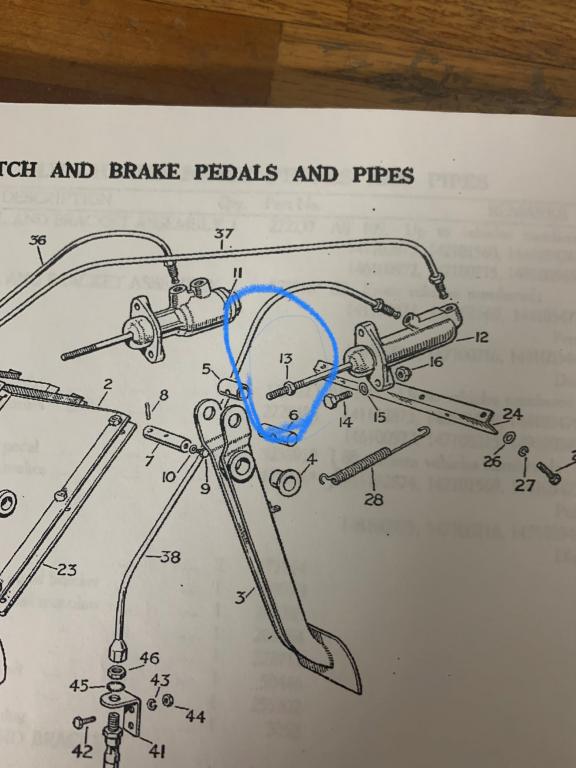

      ok, so happy to get this problem resolved! so the fix was there was a bolt on the master cylinder that connects to the pedal that had worked its way loose almost to the point it was falling off. After fixing this and putting the master cynlinder back together, it seems like its back to new again! Turns out the clutch "slipping" wasn't really an issue at all and seemed "tight" again after the fix. Going to watch it closely to make sure nothing is leaking. Seems ok now, but there was fluid loss before, so I think there still might be a leak somewhere. But its driving like a tank again, so very happy. Thank you so much for everyone that contributed to helping out! Could not have done it without the community support!
      very grateful,
      Nick
