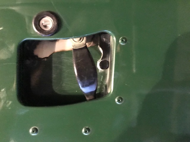

    I have a 1973 Ser 3 with the original door locks. See photo. If yours is also a '73 shouldn't it be the same?
    I suppose one could use a hole saw and cut through the aluminum skin easily enough if the lock holes were not there. The black plastic trim ring would cover any minor errors.

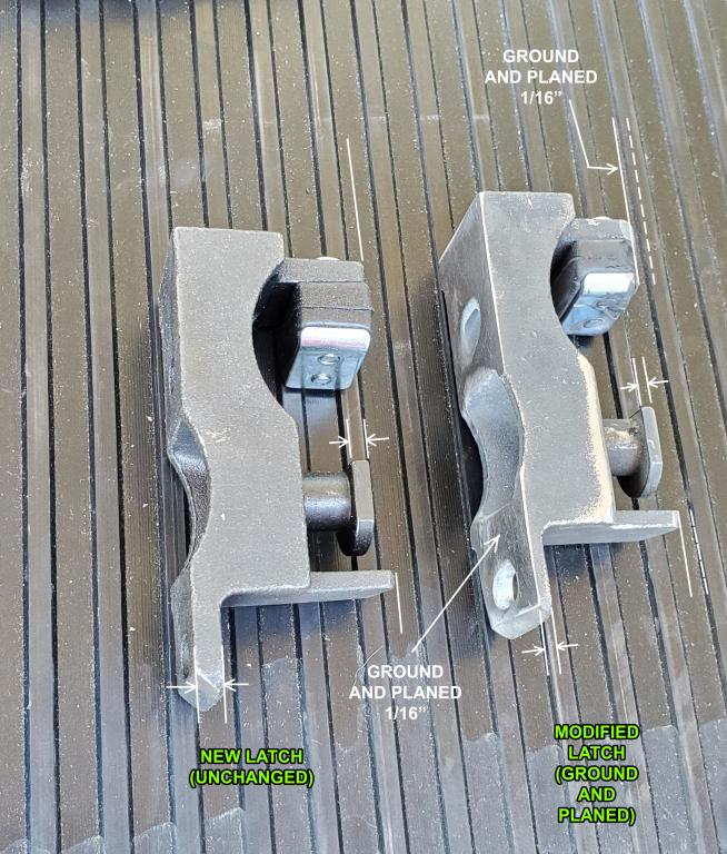

              "Genuine" part VS "Proline"

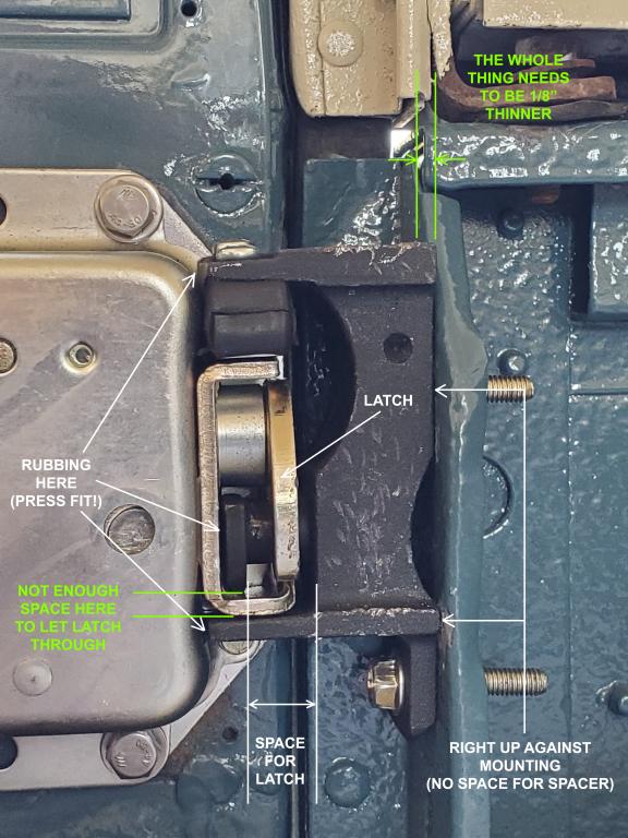

              As most of us do, I took a look at the "Genuine" door latch hardware and the "Proline" versions. I'm not usually cheap, but the genuine parts were something like $200 more expensive. So I went with the "Proline". I figured that the mark up for genuine Land Rover was exorbitant, and - surely, the manufacturing process was good enough these days that they could make a good aftermarket part. Holy moly was I wrong, and I spent 2 days basically fabricating and shaping-to-fit to make this turd work.
              The latch was pretty good. I don't have a grievance there. But the striker was just about 1/8th of an inch too long/wide. I've seen videos and looked in the parts catalog where there is a shim fitted to bring the striker "out" more. This was NOT my problem! The striker I got was TOO thick! I think, maybe, the manufacturer was trying to do away with the shim, and added the 1/8th of an inch difference to the striker itself! There is NO adjustment possible here, it's a cast part. The striker has slotted holes to adjust the fit "inside and outside the vehicle" axis. But nothing to adjust the axis "towards and away from the hinge". Check out this photo:
              ...as you can see, it's about 1/8" too proud of the attachment. There's nothing I could do but to grind it down. All kinds of interference at first. I couldn't shave it down the full 1/8" because the flange casting was only 3/16" or so. So. my only option was to shave 1/16" from each side, to combine the 1/8" I needed. So, I shaved 1/16" off the flange fitting and 1/16" at the end of the striker. Here is a comparison of the un-molested RH Door Latch (which is the same latch) I have going in next:
              ...you'll notice a huge amount of metal removed. I don't have a milling machine. So I had to use my 6" vise, and a belt sander clamped into it with 120 grit sandpaper. I think I burned out the motor, but I got it done. After a bunch of fittings and removing and grinding more, I got it to work(lock) nicely.

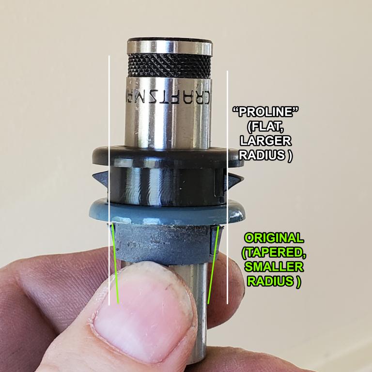

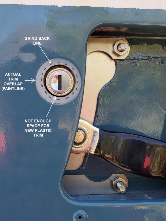

              The next unpleasant issue was the little plastic trim that covers the key-hole. The original one on the car was painted over. So I wanted to replace with the new one, for a nice clean look. Well, again, the "Proline' part was made in China an terrible fitment. As you can see here, it was all wrong. It's wider, and doesn't taper. So I had to enlarge my keyhole for this. See photos:
ID:	170101Click image for larger version
              ...luckily, the overlap on these trim pieces is so large that - well, it covers any sloppy hole adjustment. Also, the door being soft aluminum, my dremel tool with a grinder bit on the end made short work of the hole enlargement.

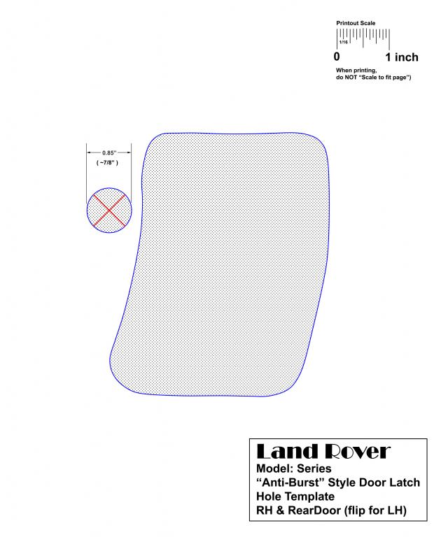

              To help myself - and others - I traced out a template. I'm going to scan this into my computer and trace out a nice vector drawing with a inch-scale to help with printing it out the right size for future readers of this post to print out. Here's the process, for anyone interested:
              Does any of this stuff fit?

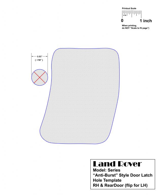

                    For anyone reading this later, I added a template you can print out and use to mark/tape up to your door for drilling alignment: (updated dimensions)
                    1) Do right-click > Save Image...
                    2) When printing out, make sure your printing preview doesn't try to stretch the image to fit on the page. Use the printout scale against a ruler to confirm it's to scale before drilling your door.
                    3) As always, this is a "good faith" effort to share with the community. Don't blame me if you ruin your door. In using this template I'm not liable, etc, etc...

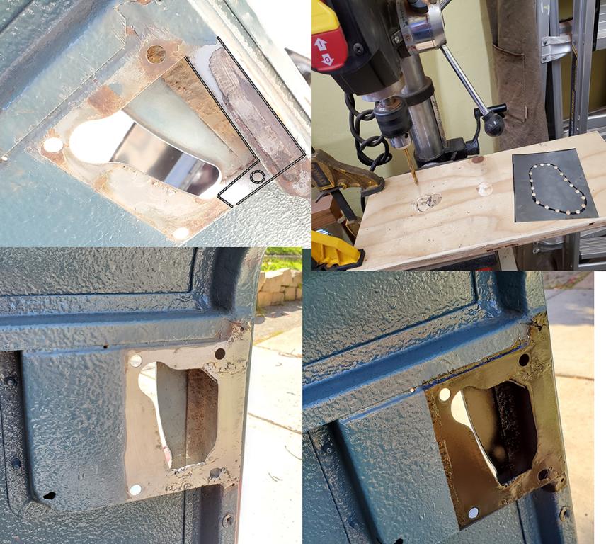

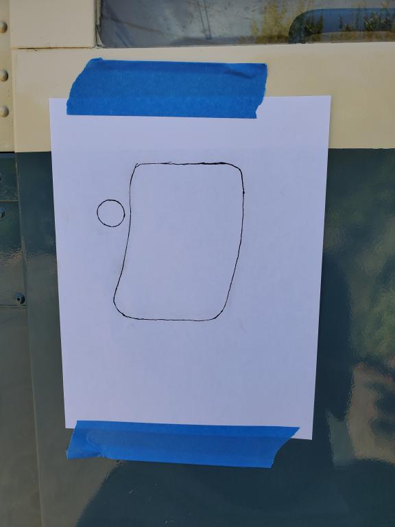

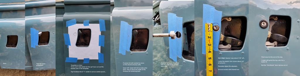

                      I finally got around to drilling out one of the front doors for the new "anti-burst" door latches.
                      Since I have documented the previous steps and findings, I'll post some more pictures of the process:
                      It seems the forum only has a 20MB total limit on photos, so I am having to crop these together to save my space.
                      1) I put some tape on the area to be drilled, hoping to save the paint job a bit.
                      2) I found that it was easier to match up the template to the handle hole that I was using for registration if I cut out the hole in the template with a razor blade on some cardboard before trying to line it up.
                      3) I decided to try a 7/8" forstner bit, because they make really nice holes for woodworking projects. Looking around on metal fabrication websites, I saw that aluminum is soft enough to use these. And it worked great.
                      4) I put the centering barb on the drill bit on the "+" center, and tapped it with a wrench to act as a center punch. I didn't want to really dent it, more like poke a hole in the tape and paint...
                      5) Even with the center punch, the drill bit wandered a bit. So- [ProTip] - use a self-centering metal drill bit and drill a 1/8" pilot hole. The centering barb on the forstner bit was about that thick at the bottom. And, with that centering hole drilled, it didn't wander any more.
                      6) The hole profile was drilled fast and clean.
                      7) Aw crap! I guess I was about 1/16th off. The plastic keyhole trim covers about 1/4" over, so we're good, it will hide any difference. I purposely put the size of the lock cylinder hole as the smaller one from my factory rear door (see previous post, the new plastic trim is larger). So I planned to enlarge to fit. Used a Dremel and metal grinding bit to enlarge and re-center to the area marked in sharpie pen. I went back and updated/edited the previous post's attached template to account for this difference.
                      8) Getting the trim piece in is finicky. There are two retention tabs on either side, but they hit the lock cylinder when trying to compress. Maybe put the trim in first, then the lock? But I had taken the door latch off and on about 8 times to adjust the fit and action, so I was not going to take it all off for a plastic trim piece. I used the Dremel to grind down the plastic inside a bit.
                      9) I had to pack it up for the day...but I might play around with the fit of that trim piece later. They are cheap, and I might buy another one and shave the key cylinder hole a little bit more for a better fit. But that basically finishes the installation.

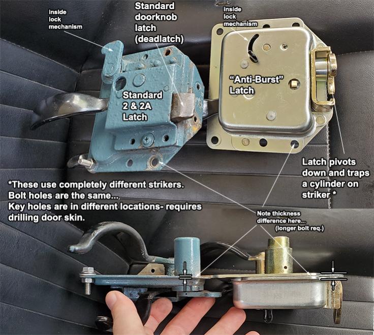

                      For those not familiar with the difference between Series 2 & 2A standard door latches and "Anti-burst" door latches - I made up a comparison pic:
                      Latch Comparison:
                      The big differences are that they use a completely different striker, and the door key cylinder is in a different place - which necessitates drilling out your doorskins (or buying doors pre-drilled for said locks).
                      The bolt pattern is the same, which is nice.

                      Also, to wrap up this project, I guess I should also mention that I had to rebuild the sheet metal under the door latch.
                      In case any of you have to do the same, here's a quick break-down of some steps I took, and a photo:
                      1) The door skin is aluminum (yeay!) but the frame and loor latch mounting area is steel (booo!)...so it rusted. Also, the previous owners had bad alignment on the latch, so they clearly slammed and pushed it shut enough to where the sheet metal ripped away. I had only 3 holes to bolt to.
                      2) So, I ended up using the door latch gasket as a template, outlining it with a sharpie on some 22 gauge steel and drilled and cut with tin snips. Fit to the missing pieces.
                      3) I did some test spot welds, then went around adding small tacks until I filled most of the area. It's tricky with this thin of metal as you burn through more often than weld.
                      4) Grind it down with the Dremel tool and hand file, then sand-paper to make it flat enough to not affect the fit of the new latch. Kind of ugly for body-work, but it will be hidden behind the door latch!
                      5) Primer and some automotive black paint so it won't rust agiain. I actually kind of like the way the black looks from the outside - it blacks out the door handle hole, and matches the black on the headlight panels. I might keep it that way.
                      I think I am spending too much time trying to save these doors!
