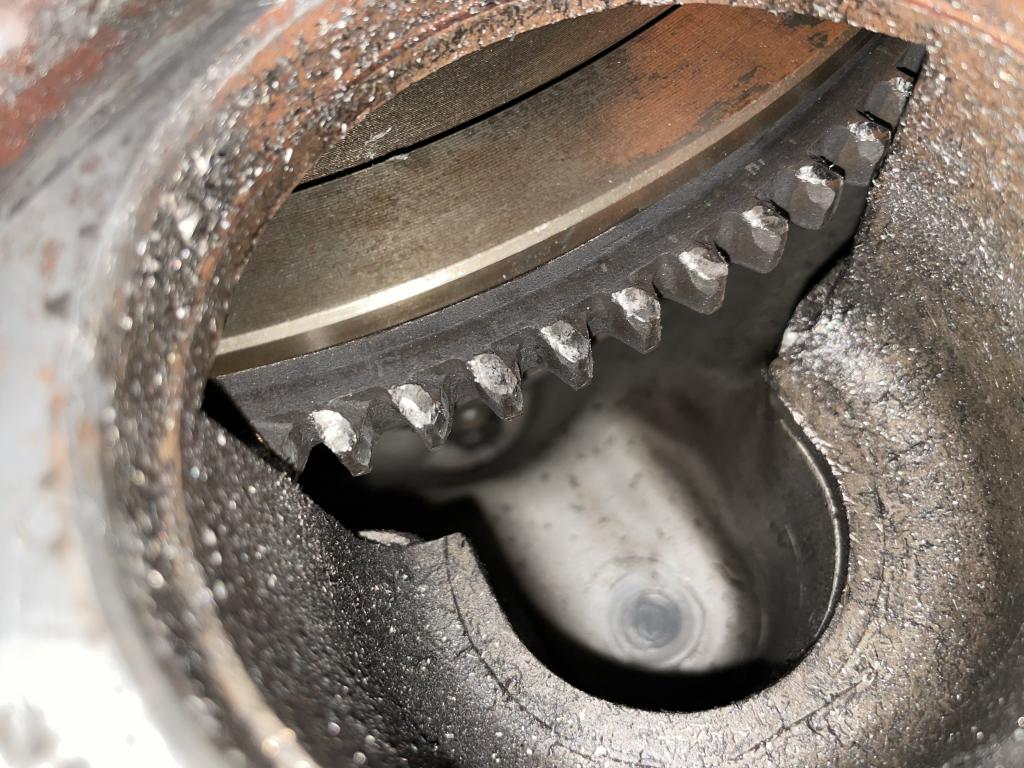

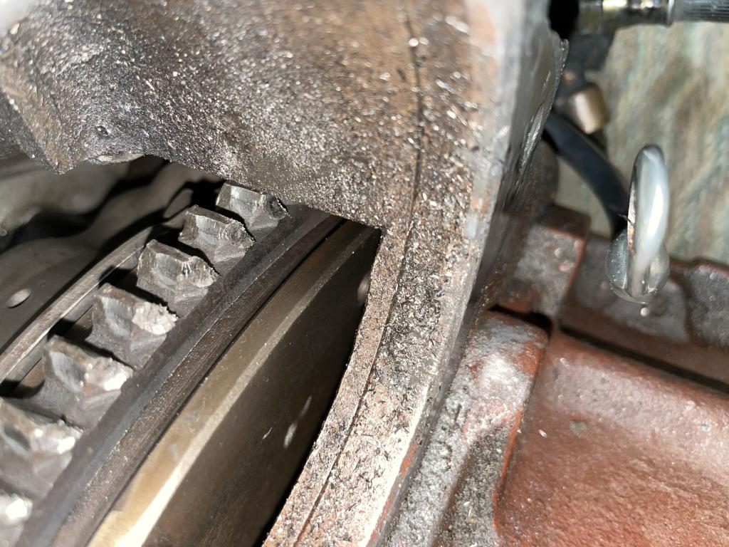

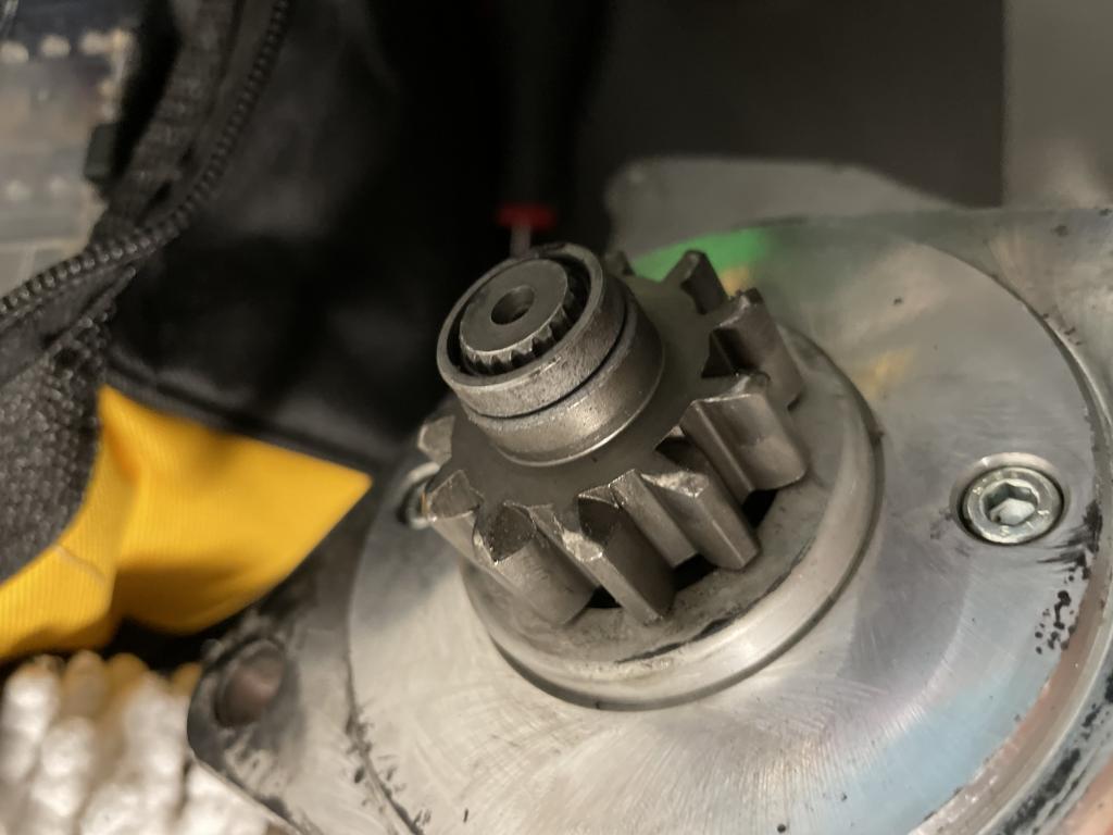

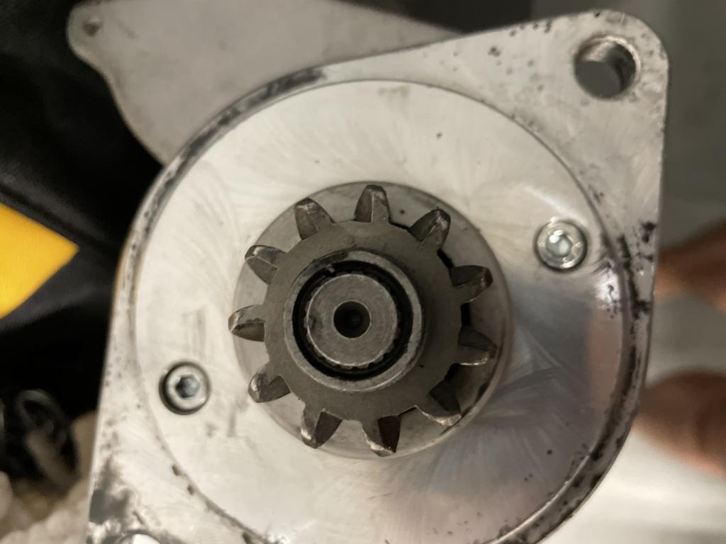

                  Pulled the starter and the flywheel looks pretty mangled. Can the bendix throw be adjusted? The starter I bought was from RN and it's the high torque starter motor for Series II-III model # PLI029.
                  My follow up question is, did I get a defective starter or am I going to have to try and source a different brand. Or do I replace the ring gear and that should solve my problem.

                    The ring gear shows signs of wear, that is part of the problem, now so is the drive on the starter, the other part of the problem, you should replace or renew the flywheel teeth, and repair or renew the starter gear,

                      good info here as I bought one of those for my S2 because previous owners shop ran it out of oil. i got it to run but can't use it (another story) but now i'm wondering if the gear mesh is not correct? this seems the more logical fate of your fly wheel? I mean the gear count, maybe it's a bit off??
                        I also wonder if the gear teeth are not engaging properly, given the wear marks on both the flywheel and starter.

                          Suggest cleaning the bendix drive with 'brakleen' and then hit it up with some wd-40. See how it works on the bench and reinstall if function improves

                            Yea I ended up throwing in the towel when I realized I couldn't swap out the ring gear myself. Taking it to a specialist here in town. My hope is that with a new ring gear they can get the alignment with the new starter correct and that will solve the problem. Since they have to pull the clutch while they're in there I ordered a new clutch plate as well so that can be replaced if it needs to.
