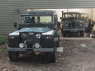

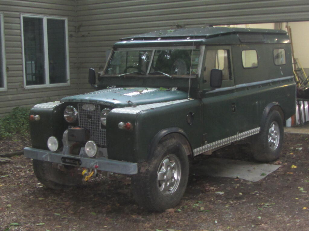

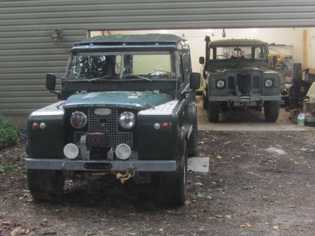

            It is the wife's 109 actually. 1968 SIIA, 3.9 Rover V8, R380 5 speed. early RR axles on leafs. My 109 is a 1980 SIII pickup, 1 ton chassis, 300TDI, otherwise stock.

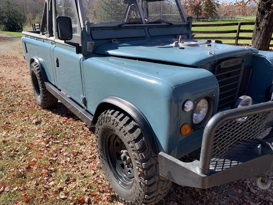

                  got the flares today , good stuff ! did you find a good way to cut off the excess ?
                  cheers

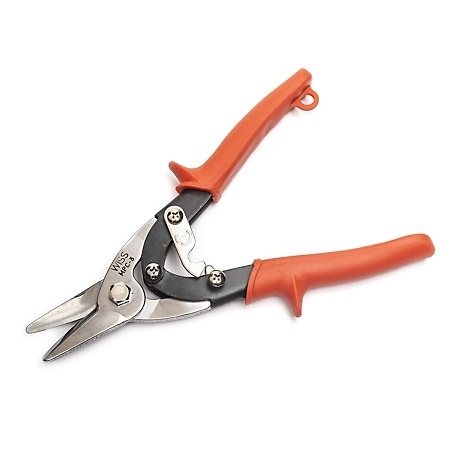

                    IIRC I just used a pair of tin snips, usually used for cutting thin sheet metal.

                      Great... did the same on a test piece... did you find it necessary to use the wire ?

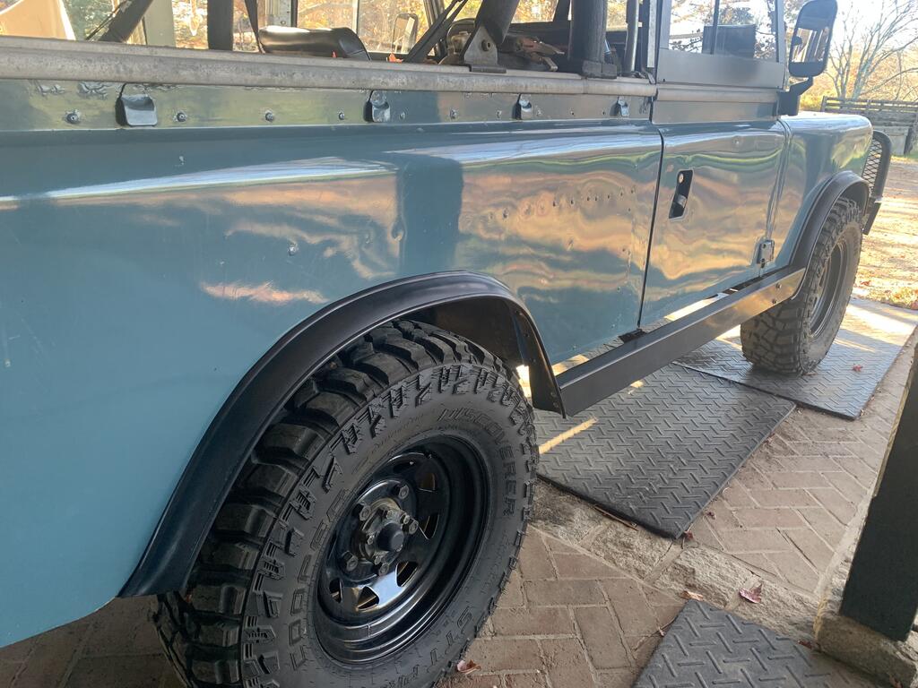

                            #14
                            Bob,
                            thank you for all your info.! these arches are great. ... they look OEM.

                              They look great and so does the truck! I'm glad they worked OK for you
                              Bob
